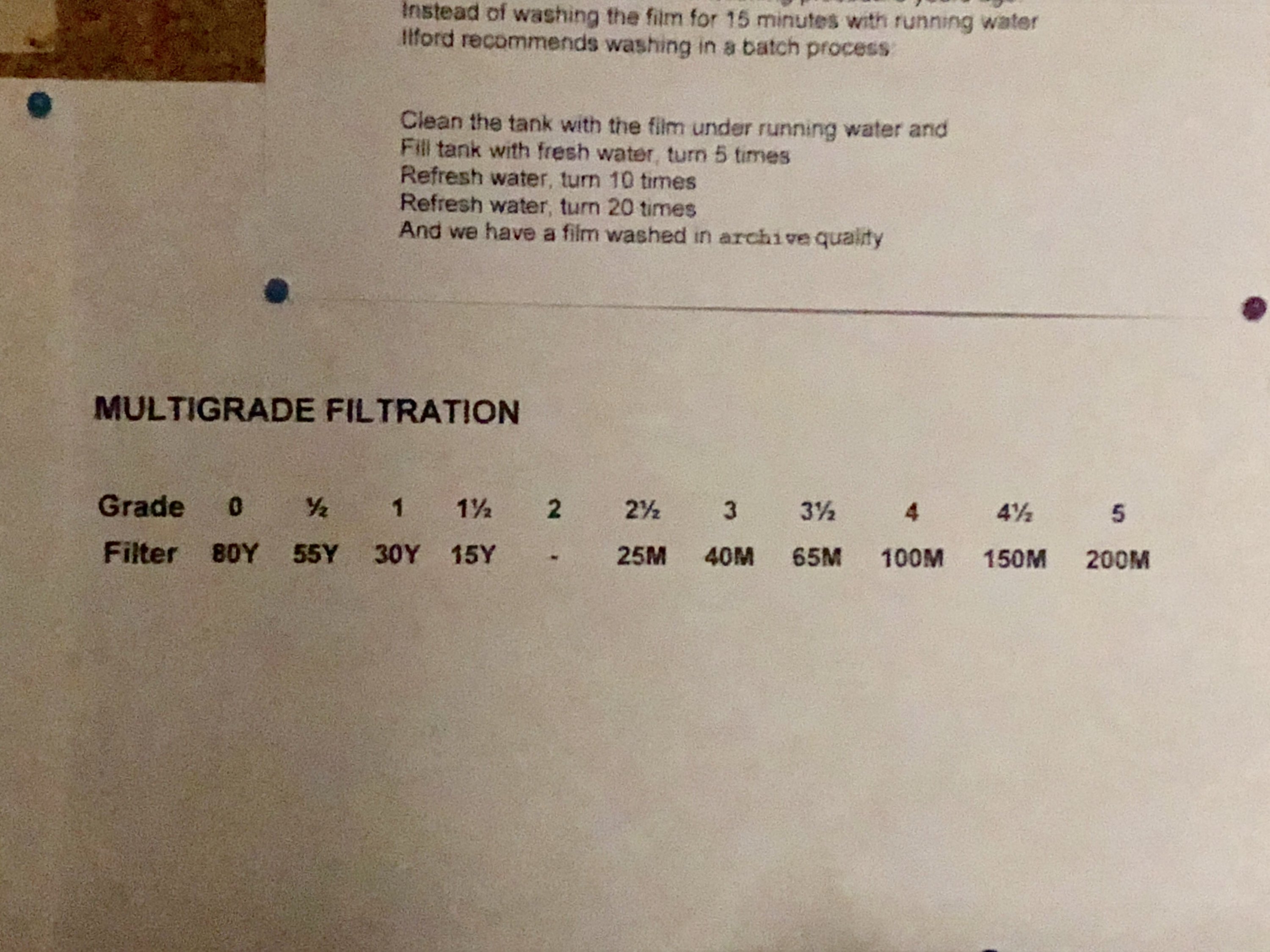

I use a colour head for my B&W printing and haven't seen any difference between this and the old B&W enlarger I used previously. My prints still print @ Grade 2, exactly like the B&W unit with a Grade 2 filter printed.
I use the attached as a guide.

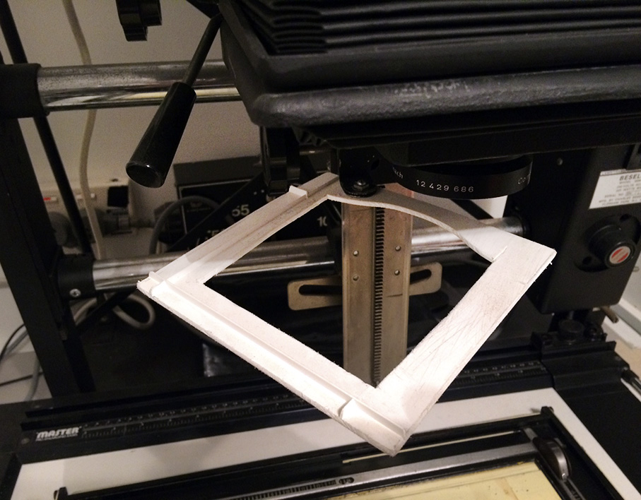

Hi - I made my own from a bit of spare plastic lying around. From memory it might have been a face plate for a clothes dryer exhaust outlet. Some 4 ply mat board off cut would also work. I just took off the red filter holder and used the same nut and bolt to hold my home made solution.
Very neat. I hadn't thought of using the red filter bar as a pivot.
