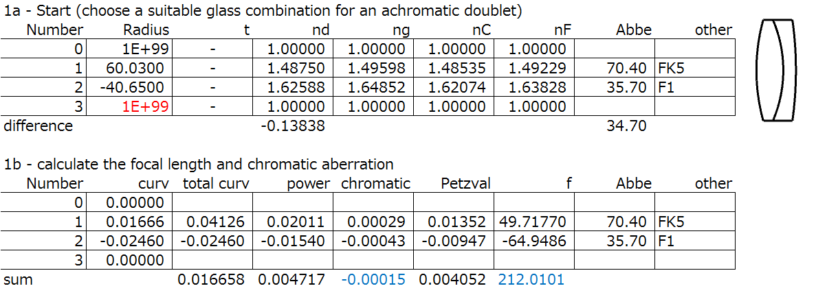

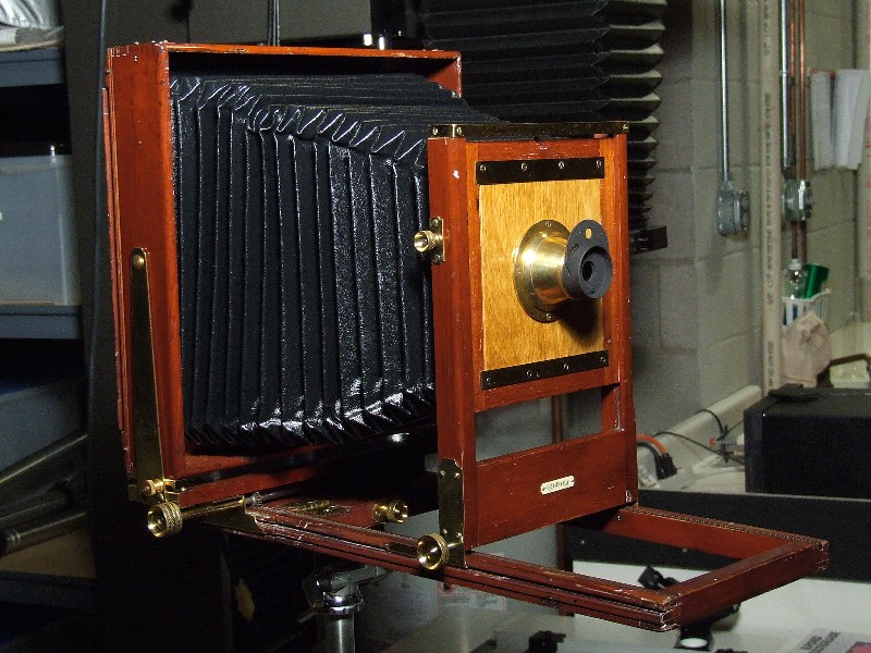

The Anthony landscape lens on my 8x10 is very sharp. No good for 'airy' portrait. That lens is a doublet. There is a raytrace worksheet out there somewhere to aid in doublet design.
