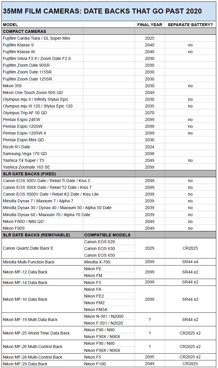

The MF-29 Data Back for the Nikon F100 goes until the end of 2049 then skips back to 1998.
Here's a list of all the cameras mentioned here so far, and a few more!

Hi, I would like to report that the MF-26 Multi-Control Back does indeed still work. I tried to advance it to the future and it went all the way to the year 99 and then rolled into year 00 and started all over. So, it seems MF-26 users are ok for a long time. šŸ˜ŽšŸ‘
