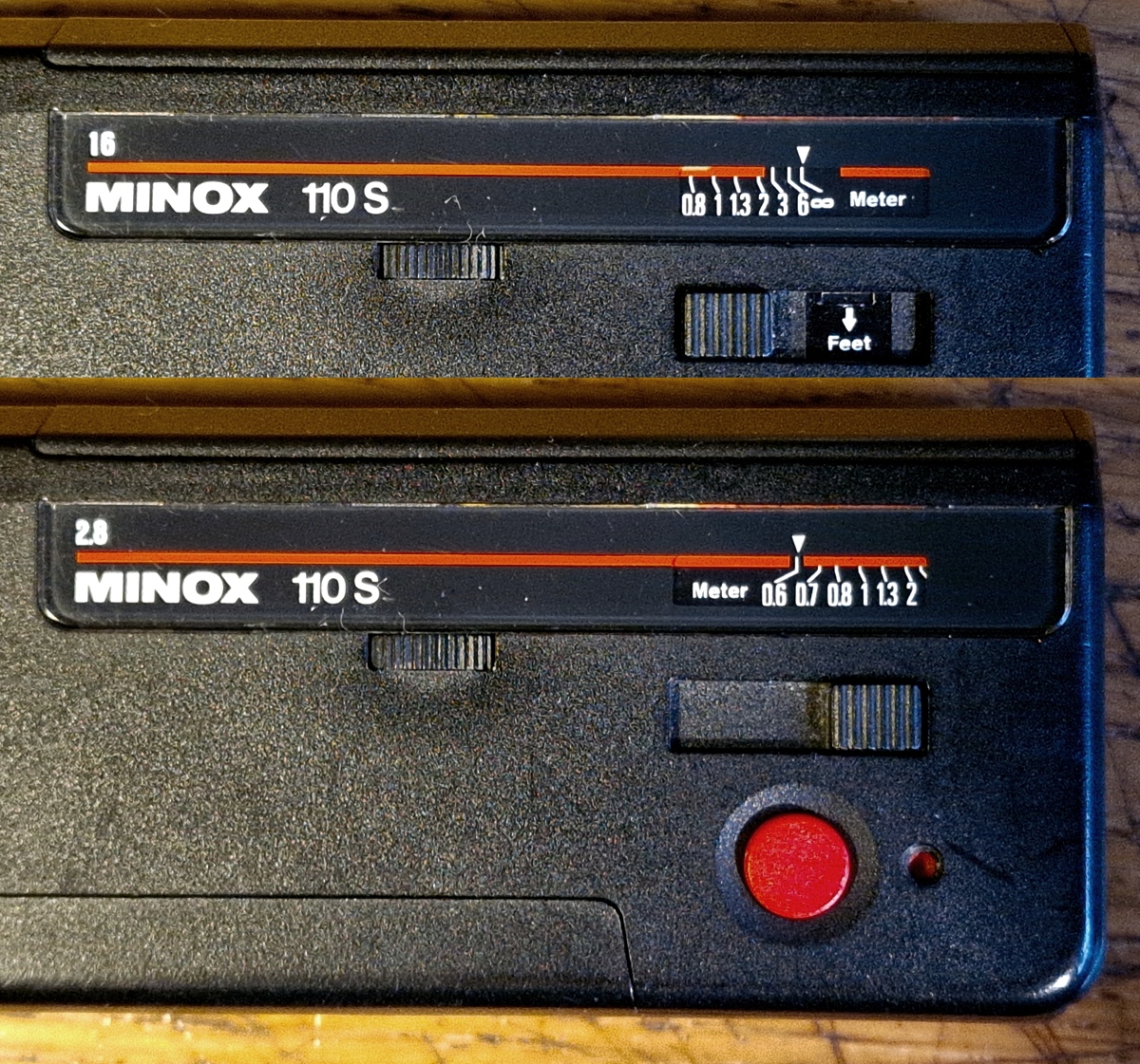

The Minox 110s, designed and manufactured by Balda in 110 format, also has parallax compensation with its rangefinder. It might be my favorite camera just for its nice details, like the way the gap in the red style line changes with set aperture to indicate depth of field.

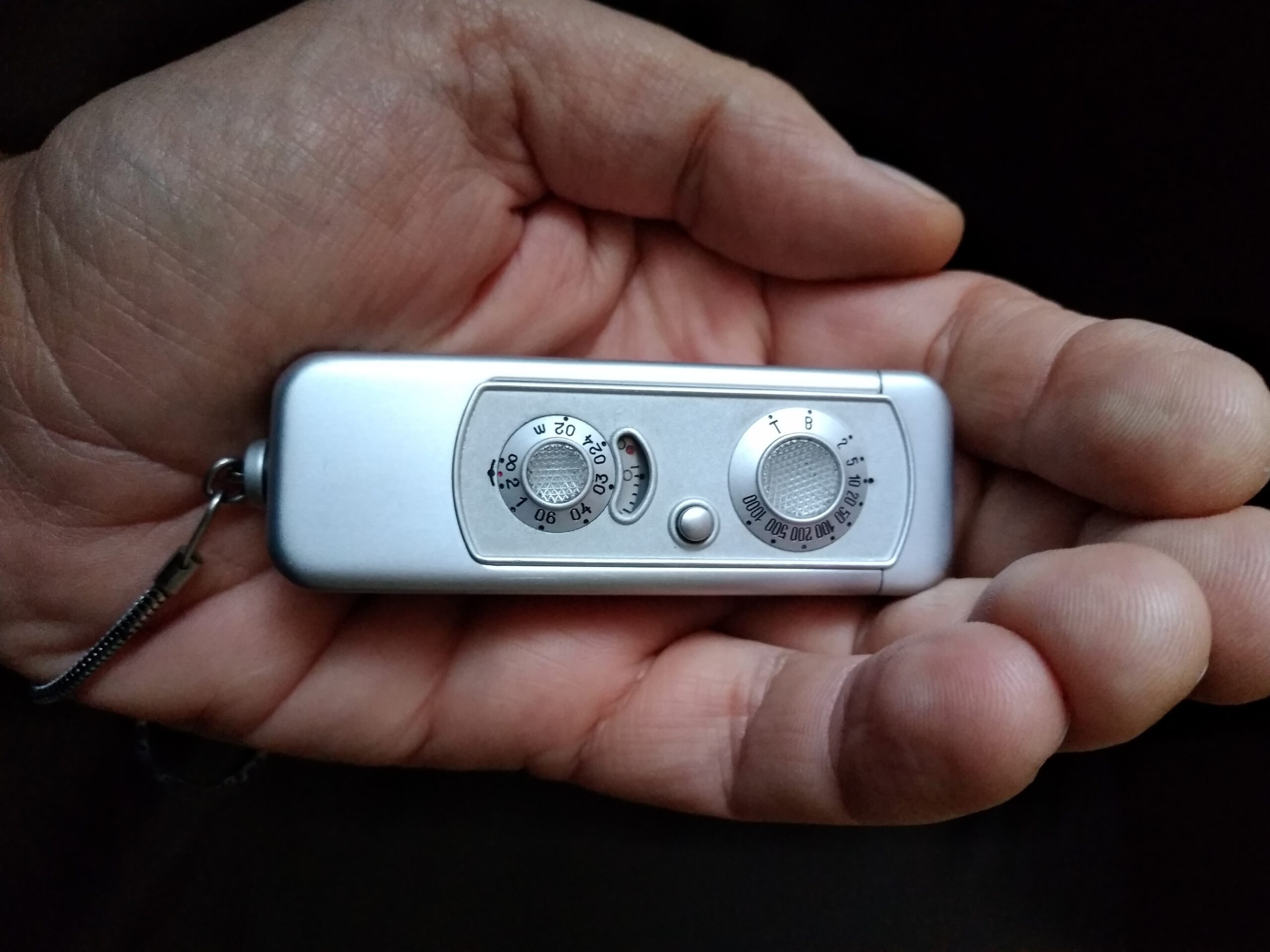

My starting point was about the automatic parallax compensation of the 8x11 Minox. As you can see here, it is coupled with the distance dial:
Based on this, I asked the question here which other cameras still have an automatic parallax compensation.
This is required with the Minox for distances between 0.2 m and 2 m. Otherwise, the frame will not be correct. So you definitely need it with this camera.
But I agree with you, at greater distances (2 to 3 m or more), you need it less and less.
