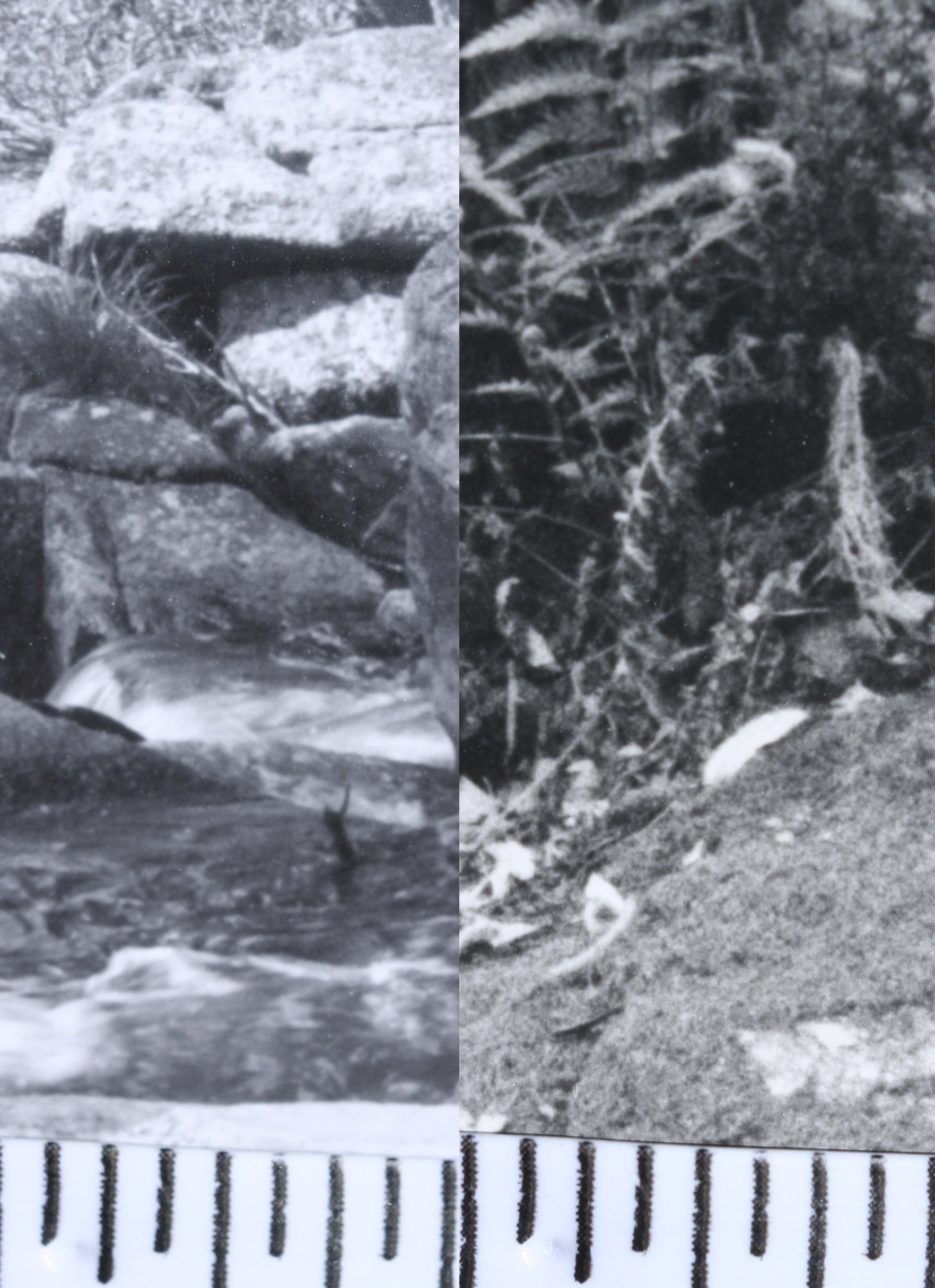

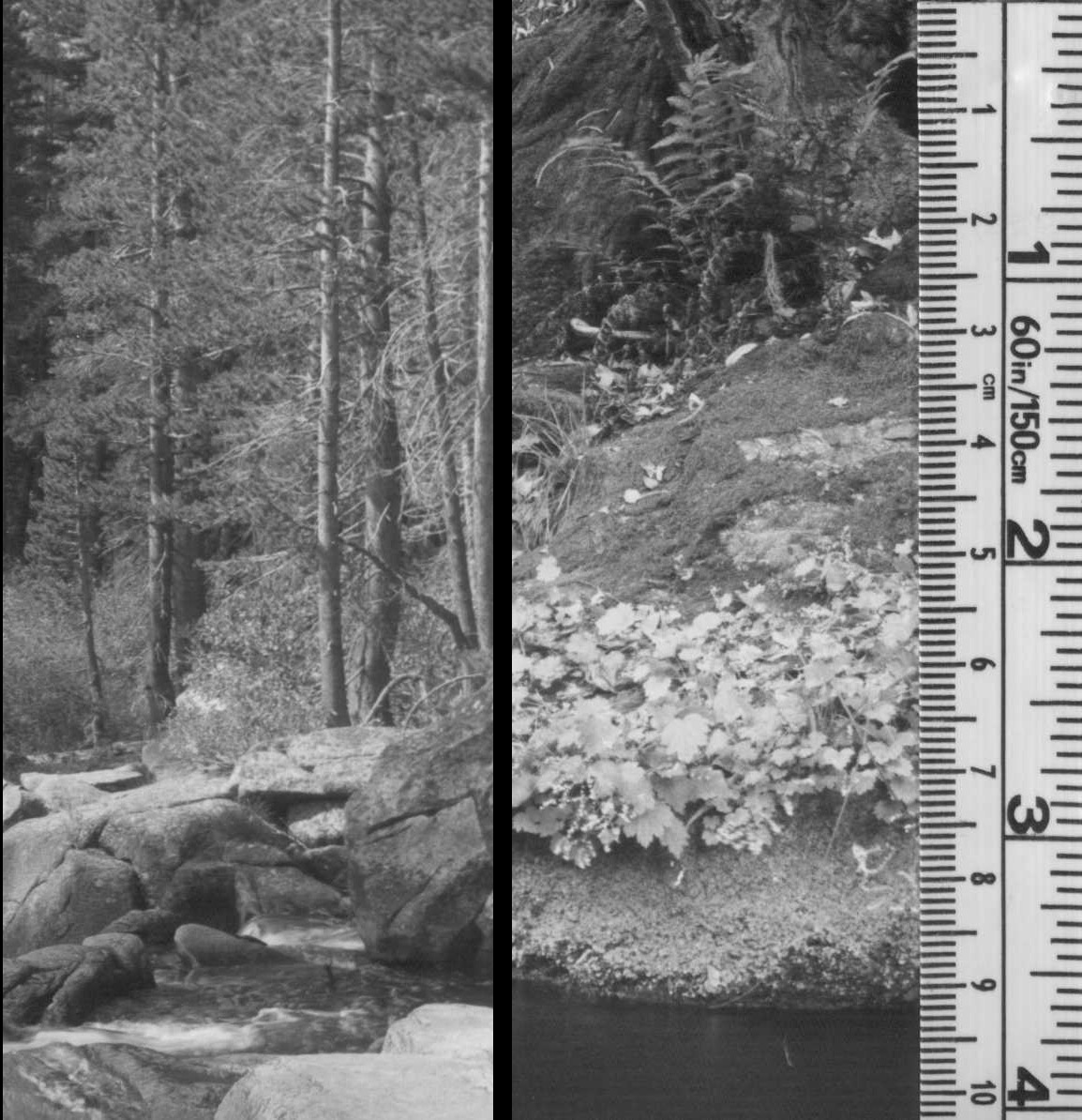

I've done a comparison to satisfy myself. Both these 11x14 inch prints are pleasing to me, and are all I want from black and white.
The conclusion I have drawn for myself personally is: 35mm fine grain film achieves results that favorably compare to 4x5 fast film when enlarged for 11x14 inch prints. In this case Panatomic-X 35mm and TMAX 400 4x5. Both developed D-76 1:1
The left-hand side was taken on 4x5 with a Camera that is more expensive than a Leica, the right-hand side is 35mm using an OM with Zuiko.
http://beefalobill.com/imgs/45y35.jpg
http://beefalobill.com/imgs/45y35b.jpg
