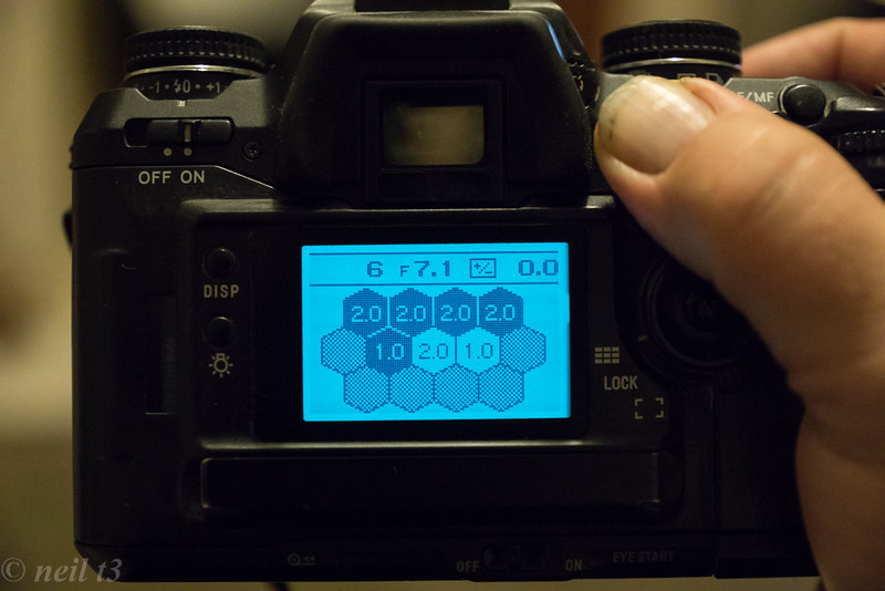

Apart from cameras mentioned in the other thread that can do evaluative multi spot metering , or the Minolta 9000AF that can be set to expose for the highlights are darker that wedding photographers used , you might have meant the Dynax 7 .
There's a setting you can use that shows 13 points on the screen when using "D" lenses that show how it's being metered .
The grey sections being mid tone , light sections showing how many stops over the 18% grey they are , and dark sections showing how many stops under the sections are .
This doesn't alter exposure as such , but allows you to judge varying parts of the exposure and chose to add or subtract exposure .

I think Drew figured it out, the later models have 16 cell matrix or evaluative metering.
Well, my taxonomy wasn't correct. I really hate any kind of camera where the viewfinder experience resembles a cluttered airplane cockpit. But over the years, I've been given a few of those in various states of working condition or not. I never actually go out and shoot with any of them; too complicated. For personal use, I'm down to a thankfully basic basic Nikon FM2n. Any critical metering is done with a Pentax 1-degree handheld spotmeter, just like with all my MF and LF work.
Yeah, got it wrong, the 9 has 14, as does the 5 and 70. So still a mystery. The Konica Minolta A100 has 34?
