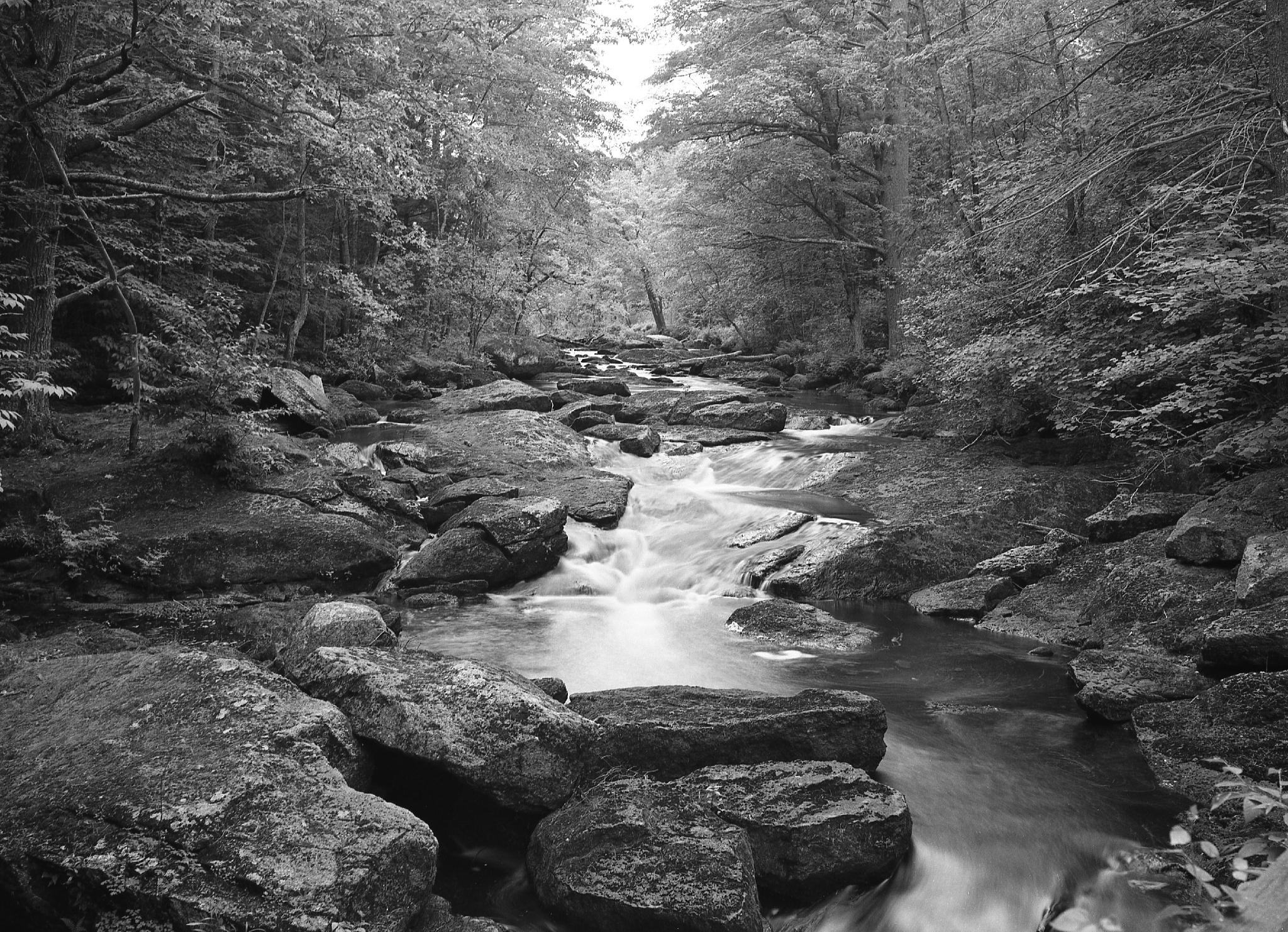

Very good stuff . . . Pan F+ and Tri-X are my two favorites. I have heaps of D-76 and Microdol-X . . . You have inspired me to do a similar comparison. Thanks for sharing. This is an image I did using Pan F+ and D-76

Thanks Locutus of Borg! I saw and replied to your comment on YouTube. Glad you are a member here. I look forward to your comparison results. Your D-76 image looks fantastic! What EI did you use?

Andrew it was a 3-4 second exposure at box speed and an ND filter, Hasselblad 500C, 80mm lens . . . I would have to check my notes for more detail than that.
