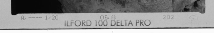

I own a 645AF and have never known this to be the case. Any idea how to activate this feature?
It's on page 73 of the manual.
Here's what I get:
attachment.php
Av = aperture priority.
---- = is where the f/ would be written if I used an AF lens, it's blank because I only have MF lenses.
1/20 = shutter speed.
0Ev = EV comp.
AS = Auto-spot metering (not that it matters what I use, it's always spot-metering on MF lenses)
202 = Index number (increments per photo)
But what purpose does this serve?
Actually, the 'index number' is the most useful for general shooting, if you're like me and constantly change backs between B+W and Colour, shoot a few rolls per outing, throw them all in the fridge when you get home and process them in batches a month or six later. Index numbers help you know what order they were shot in, at least, so you can place them better chronologically.
The Ev/Av/Tv and whatever values are mostly good for testing, bracketing etc, like when trying out a new film.
