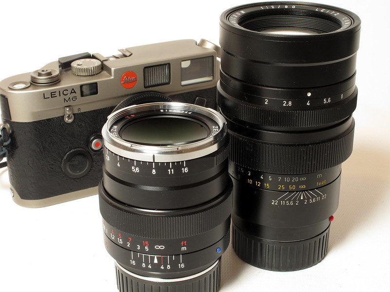

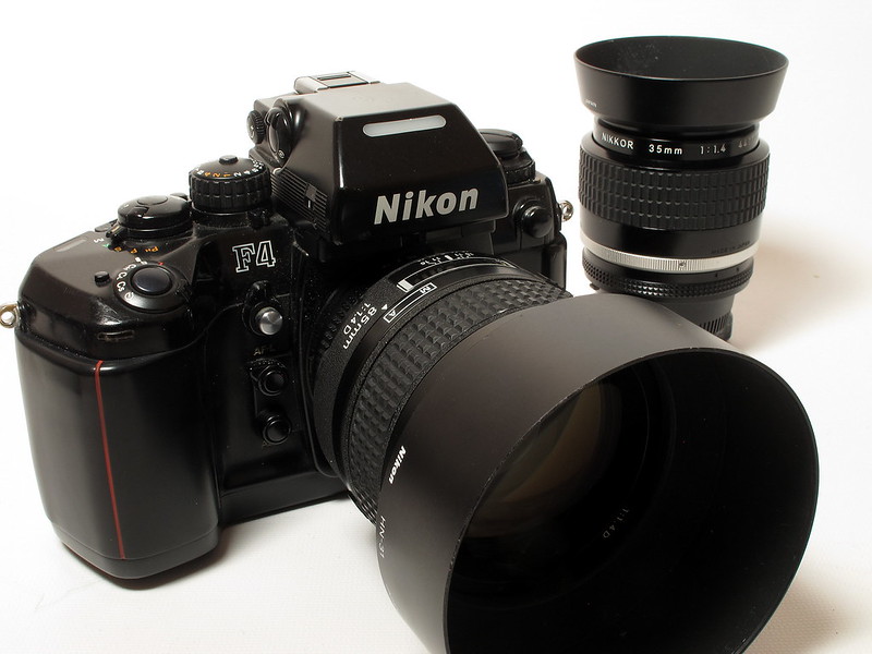

Camera System for Low-light, Long-exposure
I have two 35mm cameras that I use for low-light, long-exposure, film photography.
The first is a Nikon F4 SLR with 35mm f/1.4 and 85mm f/1.4 lenses. If additional lenses fast are needed, I add the 50mm f/1.4, 24mm f/2, and 135mm f/2.
The second is a Leica M6 rangefinder with 35mm f/1.4 and 90mm f/2 lenses. I use this when I need to shoot with less operational noise and less vibration due to mirror slap. Since you eliminated Leica as a consideration, you can substitute a Zeiss or a Voigtländer body.
Even though both cameras have built-in light meters, I prefer to also use a hand-held light meter.
SLR by Narsuitus, on Flickr
Rangefinder by Narsuitus, on Flickr
