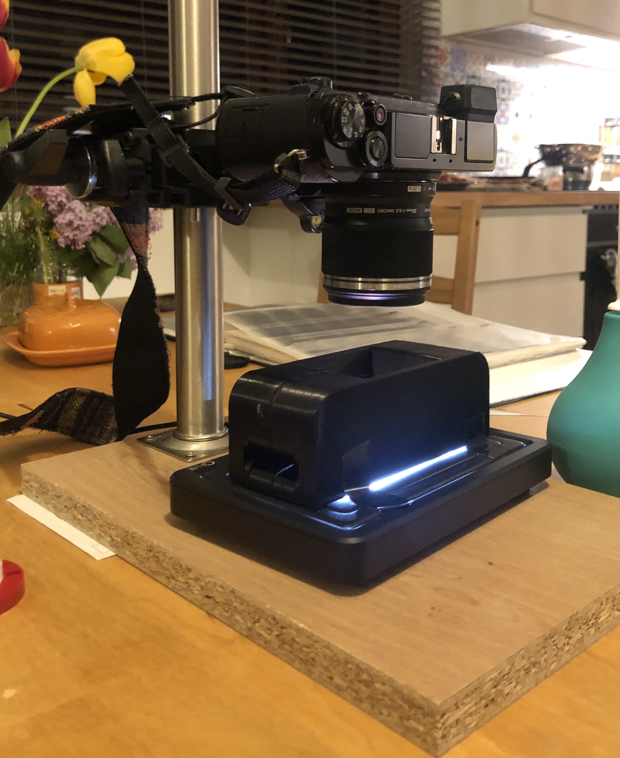

This is my setup. Fairly close but not too bed.
Thanks for showing the set up with the 30mm. I agree that’s not too bad at all.
Incidentally, is the copy stand one you put together or purchased? It’s something I need to consider since tripod use is a PITA quite frankly. I’ve been looking at tubes and flanges to attach to a plywood base, adding a Manfrotto super clamp for the camera.
Yes, this is exactly what you are looking for. Manfrotto superclamp, K&F tripod ball head, manfrotto 1/4" to 3/8" adapter, piece of plywood and furniture leg (almost the same as tube+flange but lighter). I think the Manfrotto superclamp is a bit overkill for my setup. GX9 with 30mm macro lens is pretty light. Anyway, super easy to put together and works pretty well. Probably the weakest point is the ball head. Maybe a 3-way head would be a better choice?
