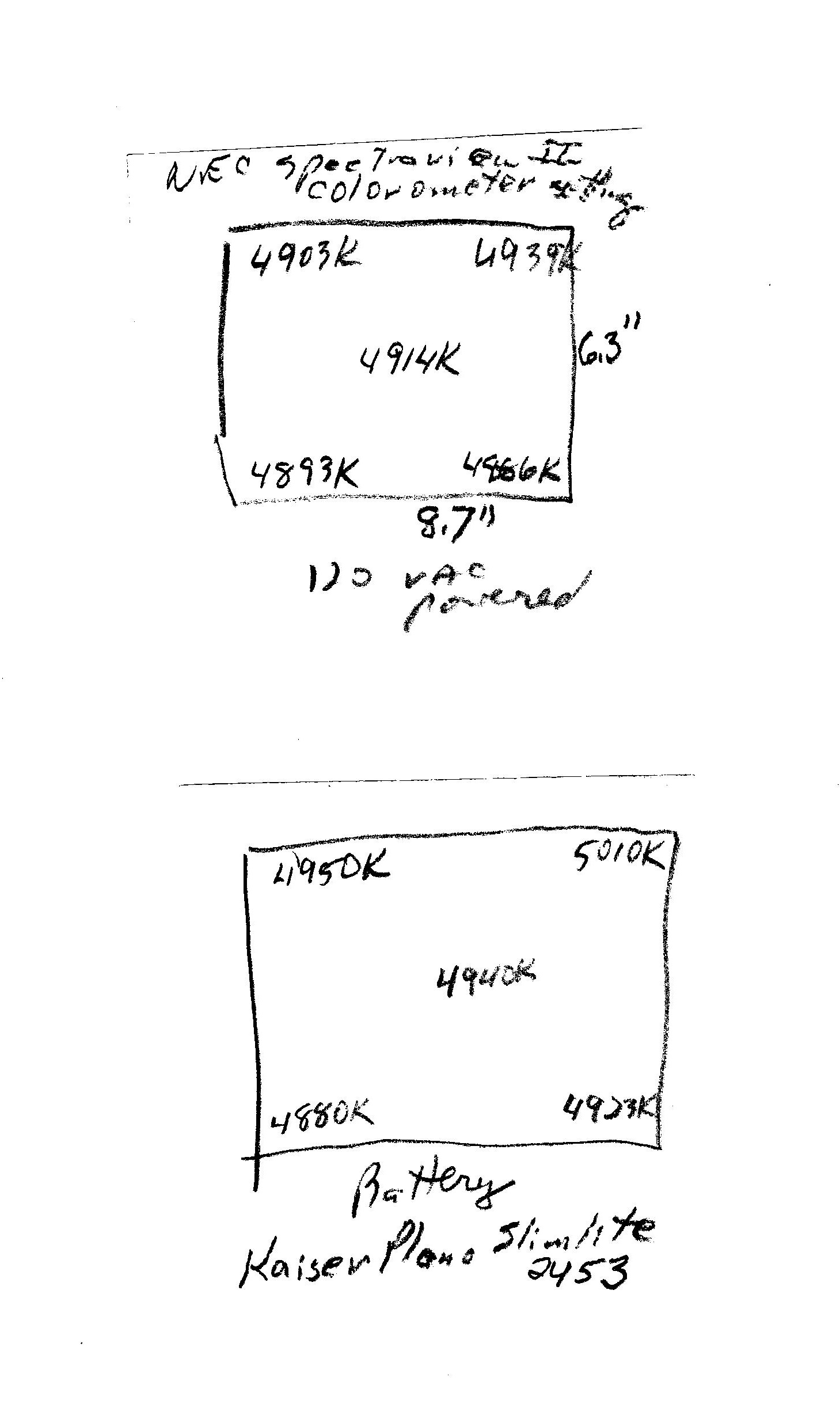

John, I use Kaiser Slimlite 2453 for reviewing my negatives and slides. It would make a nice light for photocopying I believe, although I haven;lt used it for that. I did examine it;s light output using my NEC monitor light measuring puck as shown below. The output seems pretty consistent. Interestingly, the Kelvin is closer to 5000 with the battery operation than AC. Kaiser has different size lites.
The color temperature is one thing, but more important is variation in light flux (brightness). The minor variations in color temperature wouldn't worry me all too much esp. for quick & dirty scans. variations in brightness would be a problem. It's likely easily remedied by placing a sheet of milky acrylic at some distance from the panel as an additional diffuser.
