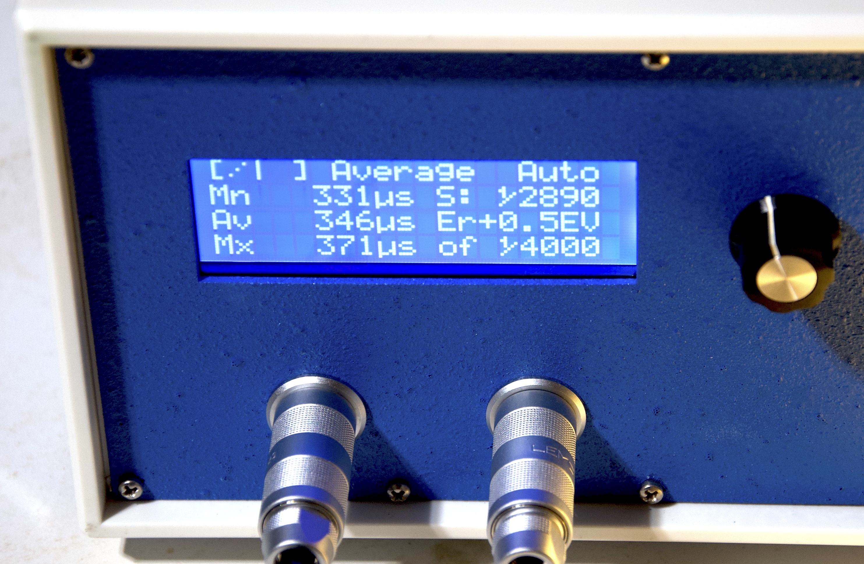

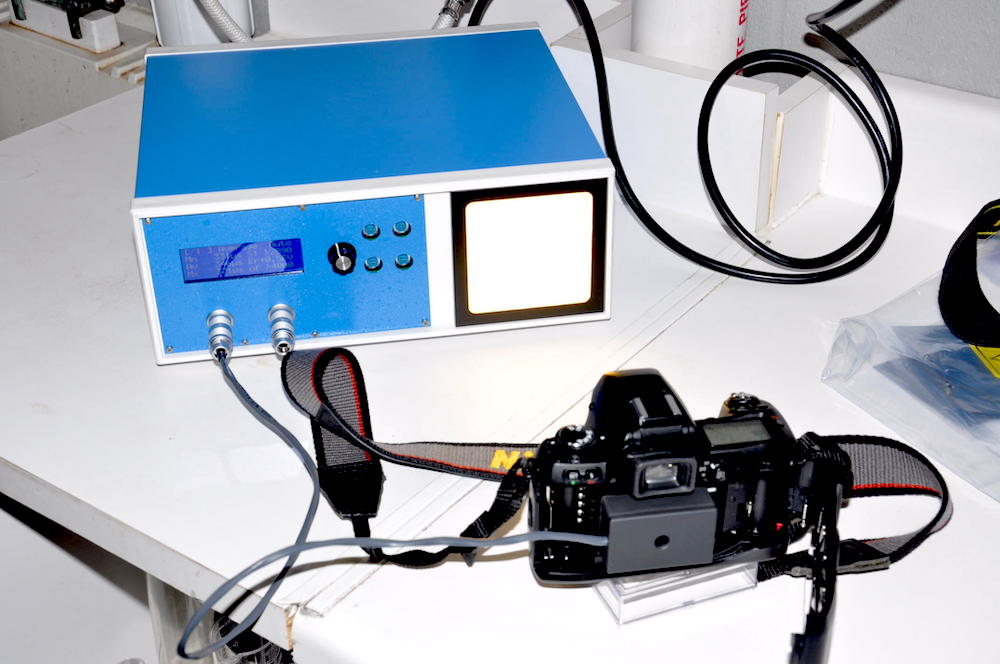

If just starting out I can recommend the plans on GitHub for this shutter and exposure tester. Very well designed. Pretty easy to build (compared to assembling a camera) if one can find all the parts on the internet.

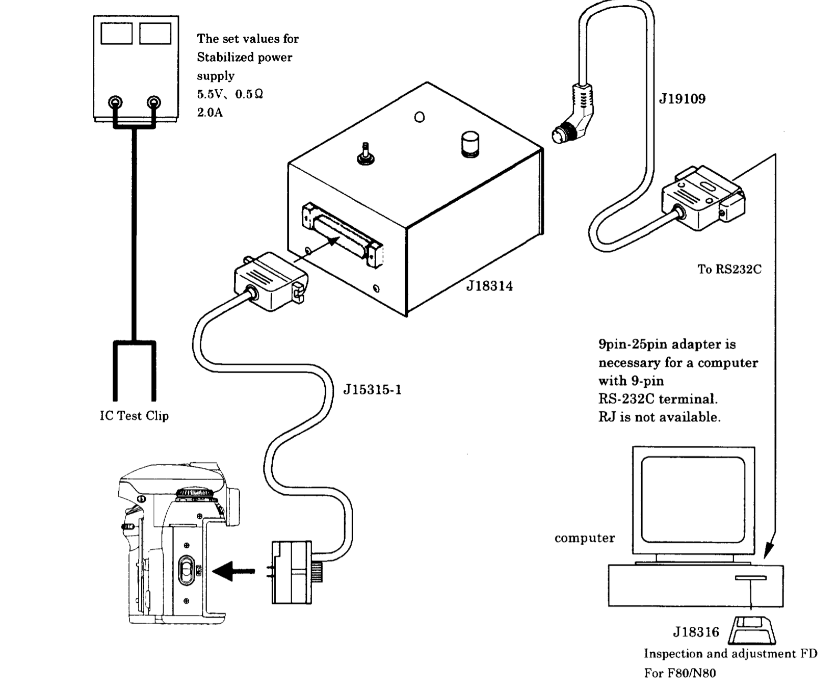

Yes! I also hope that as the electronic Nikon (and other) cameras get older people will reverse-engineer the software packages and interface modules for these cameras.
