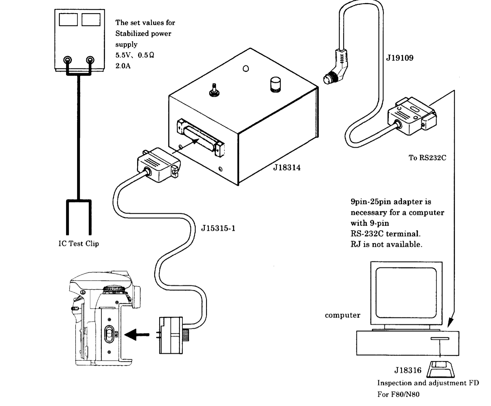

Yes! I also hope that as the electronic Nikon (and other) cameras get older people will reverse-engineer the software packages and interface modules for these cameras.
This is a great diagram, although I've not seen a floppy disc used in anger since I was about 7 years old 😂 I'll happily take any info on these arrangements people are willing to give.
