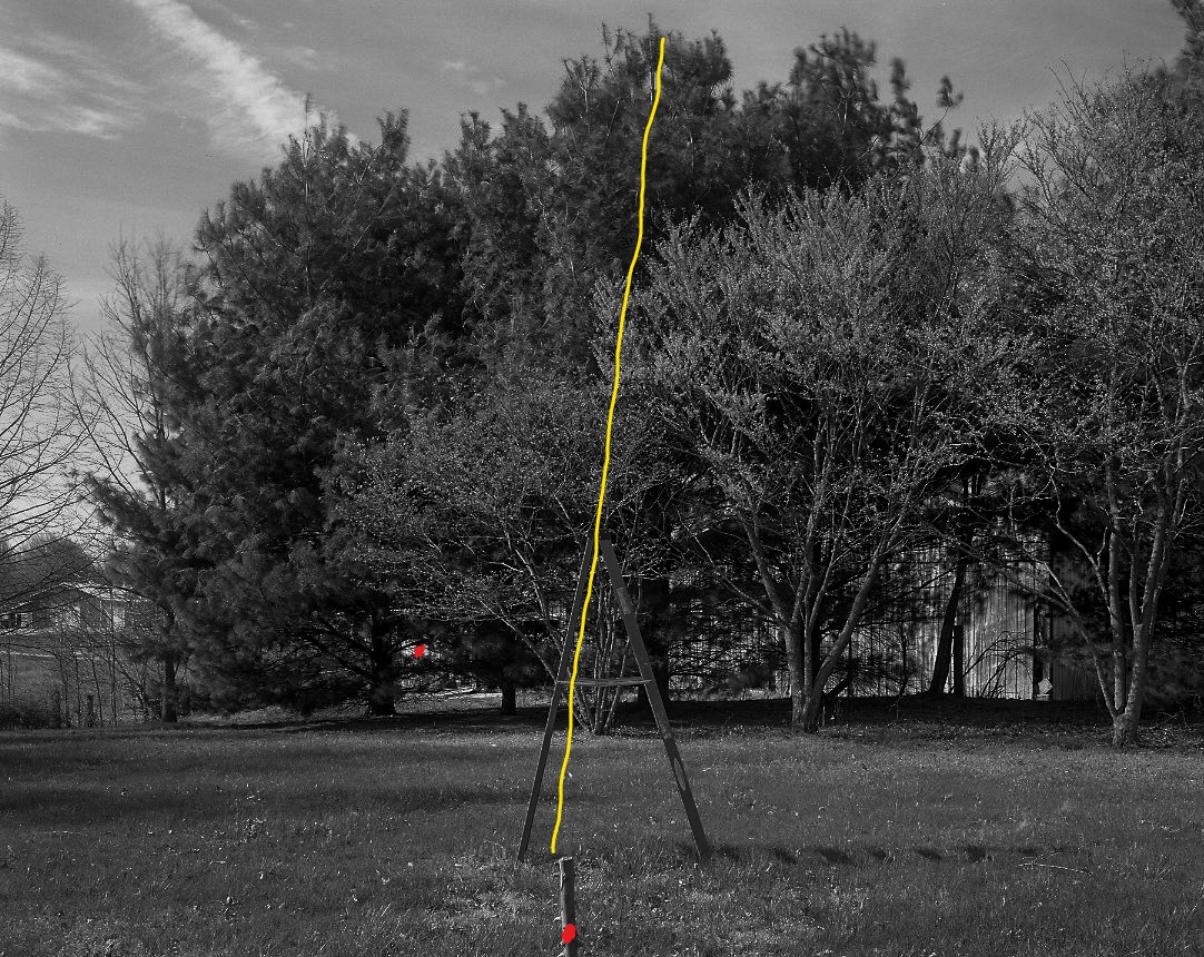

Now, if I felt I needed tilt to help get more things closer to the plane of sharp focus, I would have simply chosen the obvious "near" points for my tilt reference points for both your images. These would be for you Chuck, the closest grass at the very bottom of your image and the very top branches of the tree.
Chuck, in your image, there's nothing below the lawn, so you'd look at the base of the building at it's greatest distance from you and the clouds at the right side of the image and see which one gave you the greatest focus spread (more later).

I did this practice exposure on Saturday for a front tilt and focus spread exercise as I was trying to put into practice this focus spread idea utilizing a tilted focus plane. It's not the best example, it was a windy day and the 1/2 sec exposure does not help the example, anyway..............The yellow line (I had to free-hand it with the mouse) represents the tilted PoSF from the foreground stick to the top of the white pine tree behind the redbuds.....perhaps not the best plane because, it really left me without anything above the PoSF to use for a "far" focal point, if I understand Doremus correctly....that the focus spread needs to come from distances on the GG that are above and below the PoSF. The ladder, pre-exposure, was not in focus but I did have the top of the tree and the stick in sharp focus. The two red dots are the locations for the near and far focal points for determining the focus spread. I used the barn behind the white pines as the far point, even though it was below the PoSF. So I found the spread by using, I guess, two points below the PoSF. The spread was 3mm and I then moved the front standard to the halfway position of that spread. The aperture indicated was 32.2.....I had to use a 2x filter factor for the #21 orange filter, therefore, requiring the 1/2 exposure rather than a 1/4 sec.
I hope it is somewhat correct relative to Doremus' explanations.

Chuck,
You're most of the way there. You need to realize that when you set tilt, as you did in your example, with nothing more "above" the PoSF, that you have already found the "near" point for determining focus spread. So, the top of the near stick and top of the distant tree become your "near" and your focus is already set there, since you've just finished using those points to apply the tilt. All you have to do then is find the "far" (which will be below the PoSF). This is a trick I use often to streamline the process a bit. By choosing two points below the PoSF, you're really not finding the "near."
Next time, set up and apply tilt just as you have here, but then realize you're already focused on the "near" and note that position for determining focus spread. Then find the far, realizing that it will be below the tilted PoSF and might be physically close to the camera position.
Hope this helps,
Doremus

Chuck_P
Chuck_P
Feb 2, 2004
2,369
Kentucky
Hope this helps
It does, I can see it exactly now in my mind...............at the time I did not consider the "near" to be both the top of stick and the top of the tree, but it makes perfect sense that it has to be when there is nothing else to focus on that is above that plane......at the time I was thinking it was just the stick and that the stick itself was "below" the PoSF.
This sounds confusing but I have been going over in my mind my actions............After establishing the tilt, I noted the number on the bed, it was at 60mm, I wrote it down. Then I twittled with the focus knob ......while looking at the stick (because I was thinking I was focusing on the "near" for the first focal point to establish the spread)......looked at the mm scale again, it still said 60mm (I think this is where the bulb should've lit over my head but it didn't)......so that has to be the "near", I just did not see it that way at the time. I then focused on the base of the barn (which I knew was below the PoSF) behind the white pines, looked at the mm scale again, and it said 57mm, I wrote it down. I was thinking that I had two points below the PoSF, when in actuality, I had one point above, or perhaps more accurately, equal to the PoSF, that I did not realize at the time, was actually the "near" point. Then I moved the front standard to halfway between, what I thought at the time, was two focal points below the PoSF, when one was below and the other was actually above, or at the PoSF.
So it feels like I did it correctly without realizing that I did it correctly.
