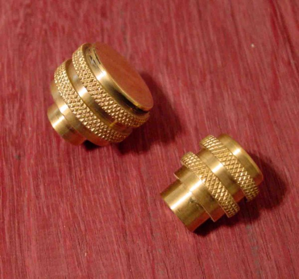

Barry, Will you be offering parts for sale? I may need some gear track and a couple of nobs for the 8x20 I'm building. The track I have now is from a Kodak 2-d as are the nobs. I know you have your priorities, just wanted to know if it is a possibility.

Hi Jim:
Yes, all of the parts for the cameras I will be selling in kit form will be available individually for those building cameras of their own design.
The gear racks you seek and the matching pinions required are available at McMaster Carr Industrial Supply which is where I buy them. You can find them at
http://www.mcmaster.com/
As for the knobs, I custom make them. I sell 1 inch diameter solid brass knurled knobs tapped 10-32 part number 1A07 for $8.50 each and 3/4 inch diameter solid brss knurled knobs tapped 10-32 part number 1D07 for $7.50 each. I have attached a photo.
I hope that helps.
Thanks for your inquiry.

Barry, thanks for the info and the link. Let me know what I need to do to buy 2 of the large nobs from you. Also, the pinons that I have from an old Kodak 2-D are in good shape and I just need to buy more track. How do I determine the pitch of the tracks? Any help you could offer would be greatly appreciated. Thanks.
Jim
