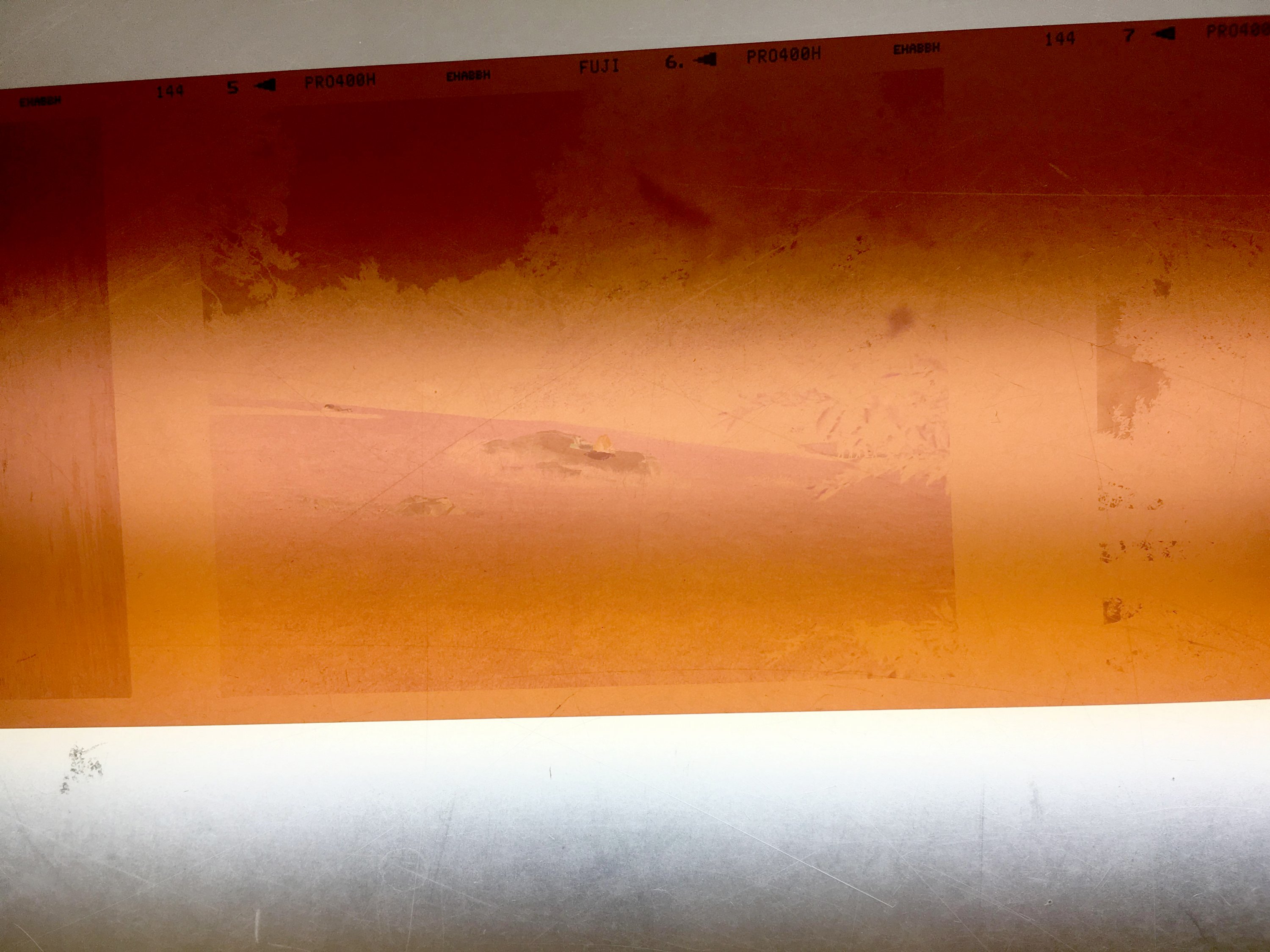

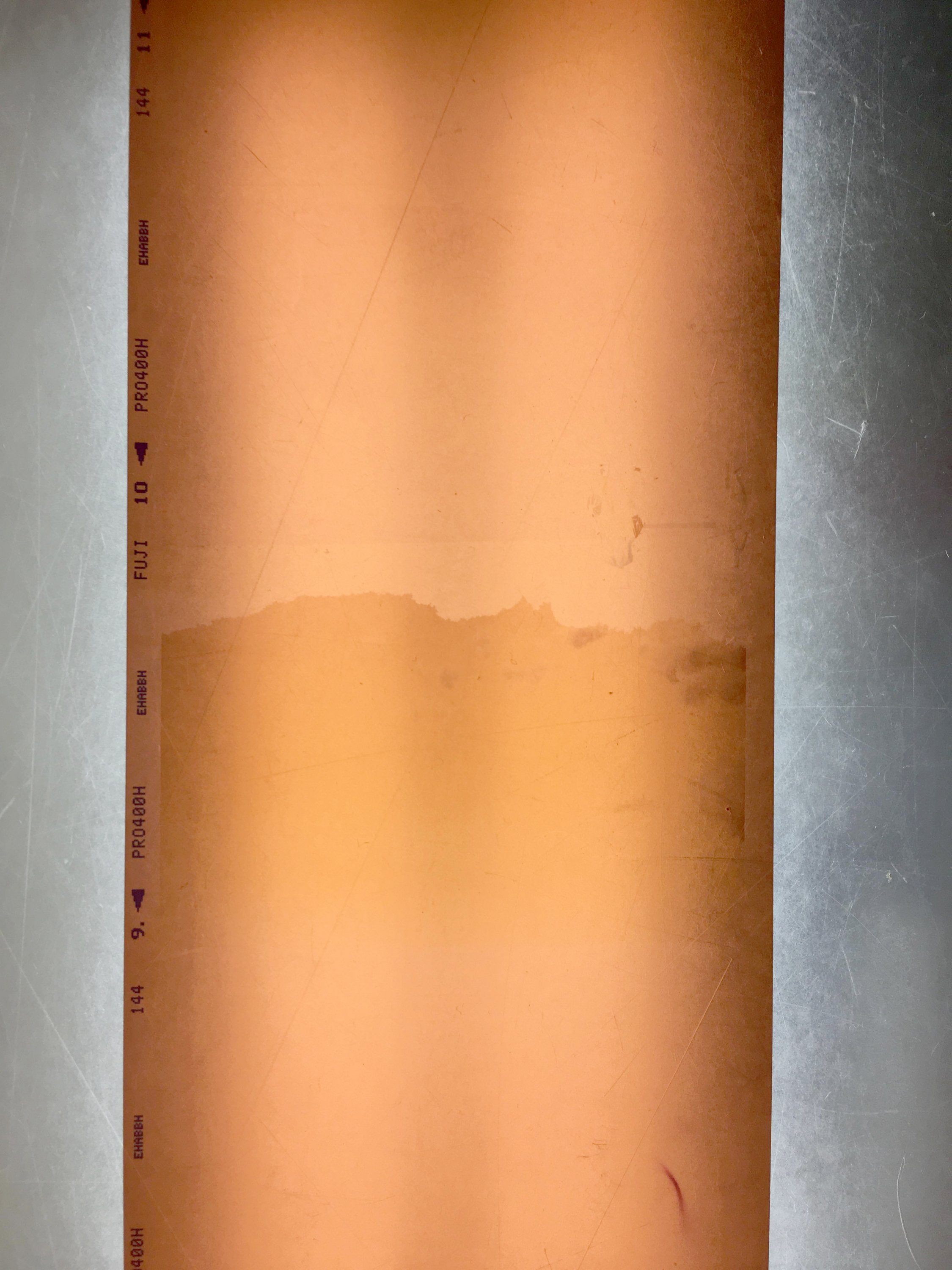

I would question the lab quality except the fact the lightstruck frame the fogged area looked like it had plenty of density. Only other avenue is to have the camera checked for accuracy. Timing on the shutter may be dead and defaulting to the highest speed.

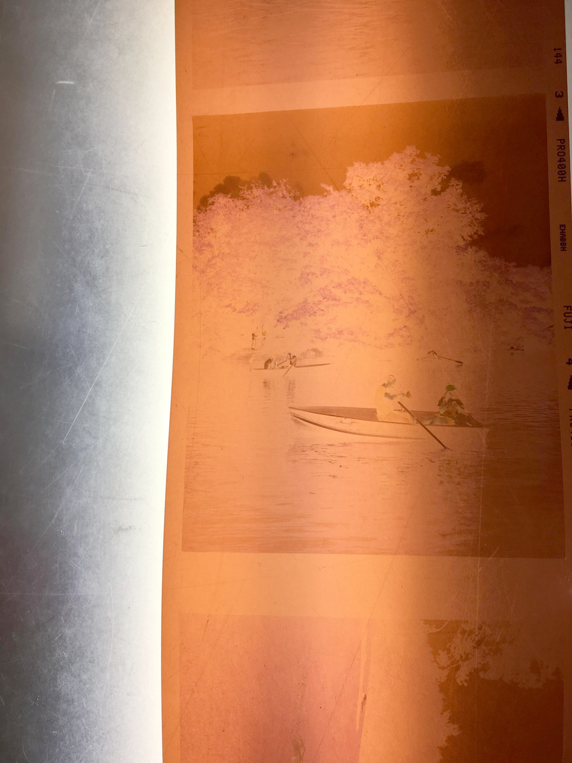

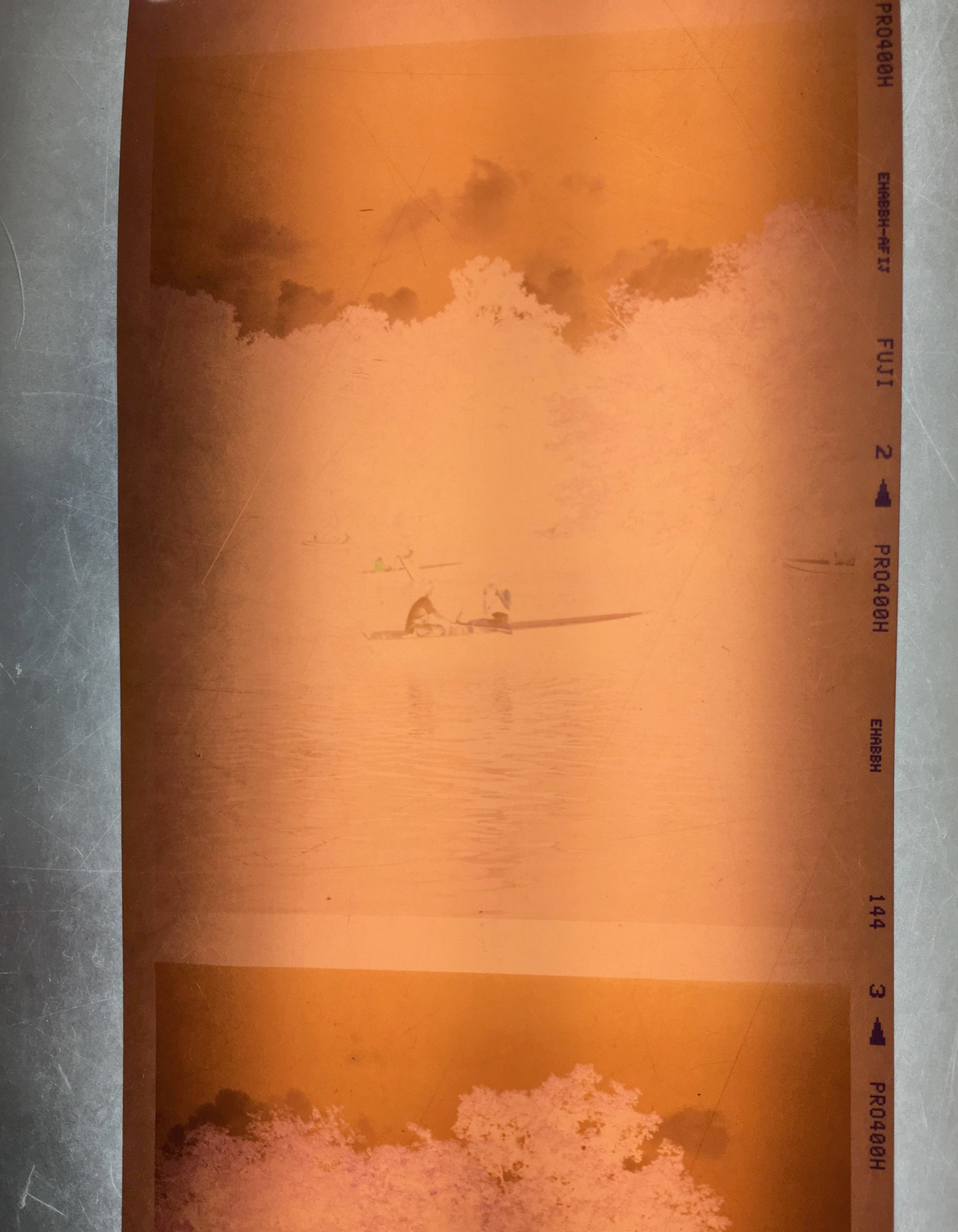

This was the best I could do with backlightning of the negatives right now. The fames look very underexposed?
You're right, those too are extremely underexposed.
They do all appear to be extremely under-exposed backlit scenes. Backlighting tends to fool meters, but if the subjects were in sun and not deep shade then the exposure settings you remembered should give better results.

Yes, underexposed.
If you look at the edge characters describing the film type and frame numbers, they are nice and vivid while the photographic negatives themselves are very thin. That indicates that the lab probably processed the film well, and your negs were extremely under exposed as others have said.
Either the light meter was giving bad information, though from your description you'd still be in the ballpark, or there's an issue with your camera or with your use of the camera. You sound like you have a good idea of what you should be doing, so I'm edging towards the idea that it's the camera at fault.
