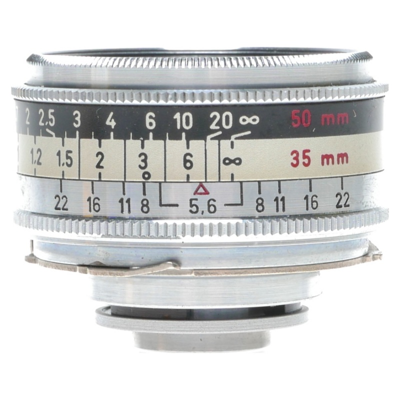

Reading the focusing scales incorrectly on your Retina IIIc auxiliary lenses. Argh!
Before that rotating ring on the lens, it was simple and easier to do (IMHO). It took a little longer, but with the older retina IIIc lenses it was like using a camer with anon-integrated rangefinder. You basically did:
- focus with the RF
- read the distance value off the top of the lens
- turn the camera over and adjust the focus so the 80mm scale or the 35mm scale shows the correct distance
- turn the camera right-side-up and take the picture.
To me thats much easier than rotating scale on the later lenses.
The original method certainly avoided mistakes. If I used them more often the rotating scale seems easier, but the way the scales are labeled, it's easy to get them backwards if you're in a hurry. Almost would have been better if the inner scale was labeled 50mm.
The color coding of the scales was, in theory, intended to reduce that confusion… in theory.
