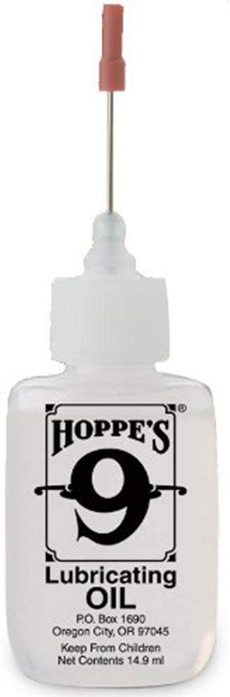

Hoppes and other gun oils seem to be little more than mineral oil. You can get a pint of mineral oil for a few dollars at the drug store.
