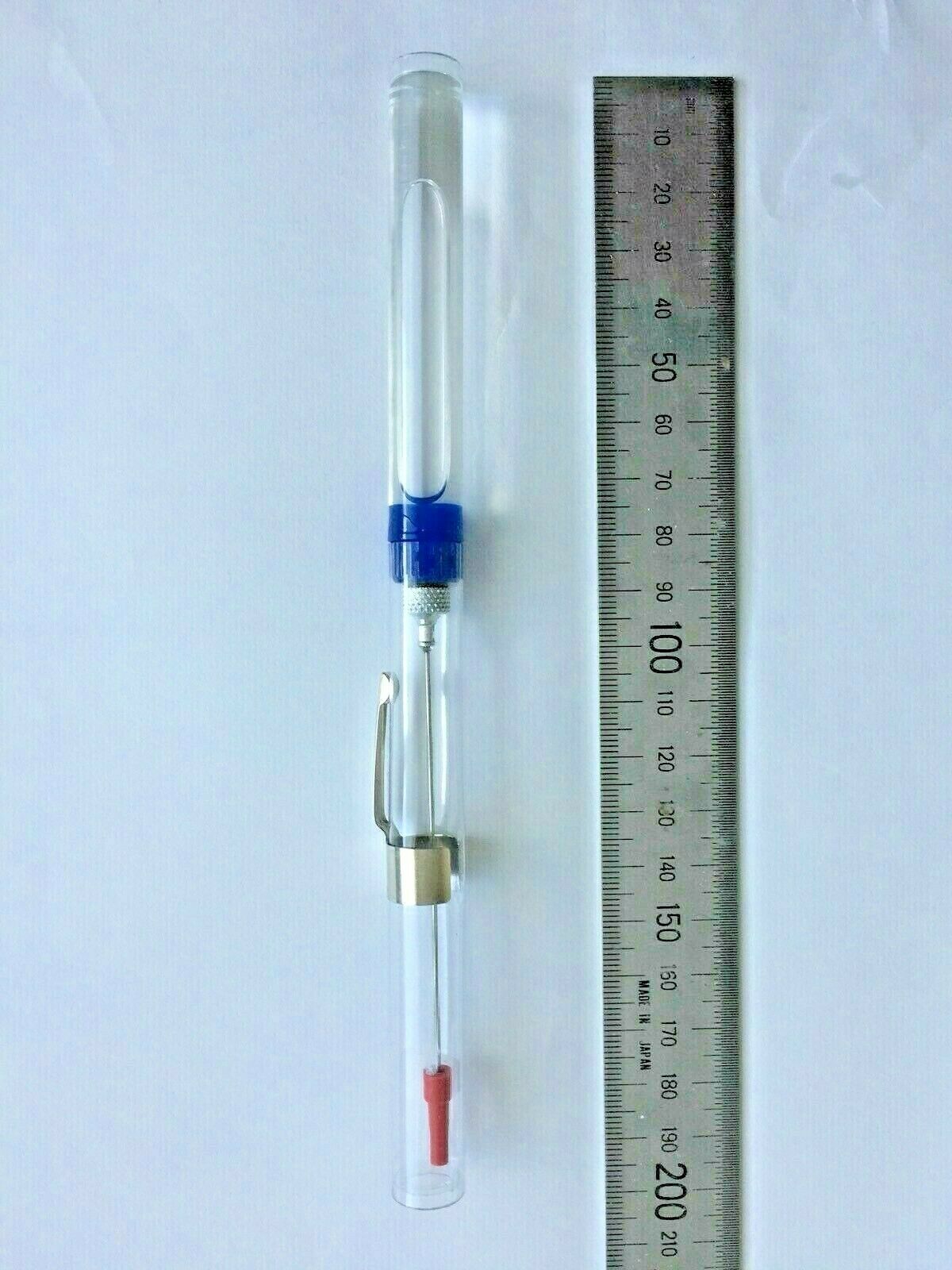

Raising this from the dead again - I have a half dozen cameras that need some help, so I plan on carefully destroying the junkers before I move on to painstakingly disabling the nicer ones. I can get tri-flo locally, but it's aerosol. Can I just spray it directly into my cameras???
I'm joking!
I'm worried about, well I don't know. I guess in my head the aerosol has some additional "goodie" in it. Can I squirt a bit of this into a syringe (or other small container) and dispense to a needle eye?

Some say you can do that. Some even suggested spraying WD-40 into a bowl and sucking off the oil. But why not just buy some liquid oil. Amazon makes that a cinch.

You can just buy the stuff in a tube with a syringe.
Best to use oil specific for small mechanical instruments or low viscosity oil with out any additives.

I use the stuff sold for model railway locomotives. These have tiny moving parts and the oil is applied in a syringe, and can be delivered in 1mm quantities or less.

I've used the LaBelle range of oils for model trains and it seems to work well. Perhaps the most important part is not to over oil, same for clocks. Just the tiniest amount is all that is needed.
