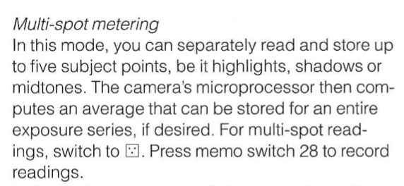

By 'the average' you mean the multi-spot feature resulting in the camera computing the average of the measurements? Or average/evaluative "automatic" metering with no spot metering involved? The latter I only use on cameras that have nothing else; i.e. older, more basic SLR's. On the T90 with multi-spot the camera automatically calculates and average and you can then easily shift that up or down using two buttons on the back of the camera. All measurements remain visible on the metering scale, so you can actually see the whole thing go up and down until you're happy with where it is. To me, it almost feels like shifting the entire image curve up and down; it's very intuitive. The only thing I can't wrap my head around is why they abandoned this system.
