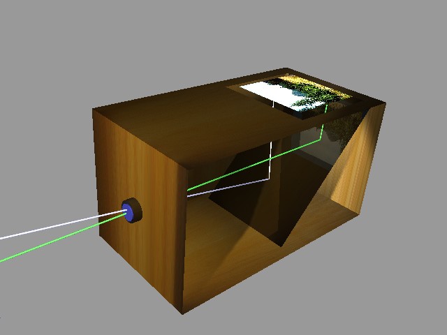

An orthographic projection is what you'll get with the original camera obscura, a 3D image converted into a 2D image:
A stereographic projection seems very difficult, if not impossible to do with a pinhole camera? I'm not sure if I understand the concept of stereographic projection. My bowl suggestion above could be considered a (inverted) stereographic projection?
