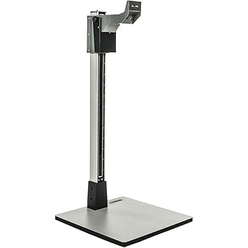

Yes, used enlargers are cheap these days. The are also very big and heavy, which is apparently why they call them en"large"rs. In a dedicated darkroom this may not be an issue, but it is a non-starter in my bathroom. As for focusing and scaling, that's a feature, not a bug. For 35mm I have everything from a 18mm to a 600mm lens, macros, extension tubes, etc. It seems unlikely there is any situation that couldn't be accommodated. I already have a copy stand for mounting and height adjustment. Although I don't have enough experience with printing to know how to get the best from using filters, it would seem that a properly exposed negative would be the best starting point.
That just leaves the light source. One advantage of this d!&!+@l era is that LED light panels, with adjustable brightness and color temperature, are readily available. Mounting them to prevent stray light would not be very difficult, especially since the copy stand was made to allow stacking of multiple devices. This seems a far more practical approach for occasional printing than a cheap, used enlarger.

I already have a copy stand...The are also very big and heavy...
Your copy stand will have to be as big as the column of an equivalent enlarger to make the same size prints. Have you ever seen the head of a 35mm enlarger? They can be pretty small and light. Depending on which 35mm camera you use, it could wind up being heavier than an enlarger head because you will have a shutter, mirror, a focusing helicoid and extension tube ,film transport, batteries, pentaprism, etc, not found on the enlarger head.
