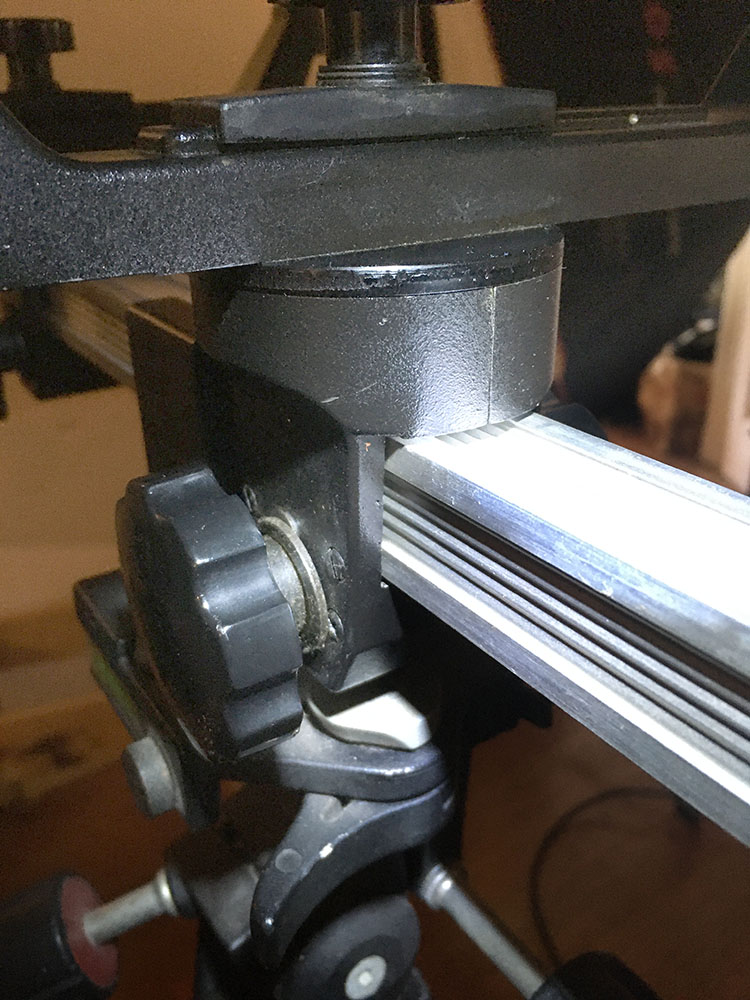

Here's a pic.
The knob that unlocks the movements? It just unscrews all the way, and there's a washer beneath it. Looks like the allen screw that's hidden when the standard is mounted on the rail is the next step, but I still have to get an allen key that fits in there better to try it. I have a test shot locked in right now so I can't take it apart til I get through that.

There’s an optical illusion in your post 7 photo.
The disassembly/assembly of the standard to the rail block difficulty arises because there is an M6 x 1.0 nut tightened to the M6 x 1.0 mm-pitch x 50 mm socket-head screw that fastens the standard to the rail block below it. The nut is essentially inaccessible. It is this screw and nut that fastens the standard to the rail block. The head of the screw is on the underside of the rail block and clears the top of the rail in assembly.
The knob (mostly obscured) is seen in the photo atop the side-shift clamp on the horizontal base of the standard. It threads onto the end of the M6 socket screw. There are two greased washers directly below the hub of the knob. These two washers bear against the rim of a steel cup (described below). The knob simultaneously locks the left-to-right shift and the horizontal pivot of the standard. If you enlarge the photo of post #7, you can see the hub of the knob, the two steel washers below it, and the rim of the steel cup resting on the side-shift clamp (textured black plastic).
The nut is recessed down into a steel cup of about 13 mm hole diameter. The distance across the diagonally-opposite corners of the nut are about 11 mm. That leaves about 1 mm clearance between the corners and the ID of the hole in the cup. It gets worse. The nut, at least on mine, isn’t perfectly centered in the cup. That means that at least one of the corners has less than 1 mm of clearance with the vertical wall of the cup.
The wrench size of the 6 mm nut is 10 mm. Where does one get a 10 mm socket with a side wall thin enough to fit into the 13 mm hole of the cup and strong enough to loosen/tighten the nut while holding the screw with a 5 mm Allen wrench from the bottom? The wall thickness of such a socket would have to be on the order of, say, 0.9 mm or less.
There’s one more complication. There is a thin, formed-steel retaining clip of some sort fitted atop the nut with 3 tabs 120° apart that appear to fit into the thead of the screw. I surmise that it is intended to prevent the nut from loosening in use. Possibly, the clip is swaged onto the end of the nut. I can' t tell from the limited view I can obtain.
Obviously, Cambo had an efficient way of dealing with this. I don’t know the answer.
