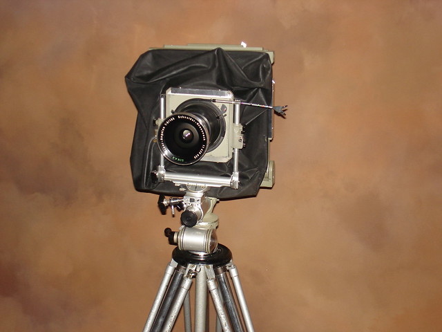

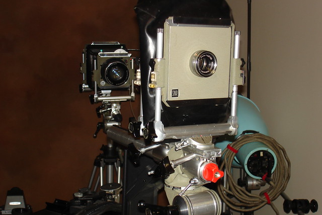

Here's a couple of Normas in my studio; the front and rear Norma standards can be made to touch each other; that is adjustability! :smile:
DSC05904 by Nokton48, on Flickr
DSC05783 by Nokton48, on Flickr

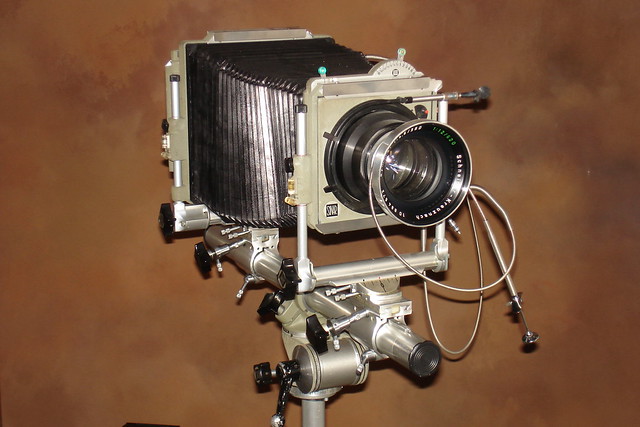

Here's my 5x7 Norma
001 by Nokton48, on Flickr

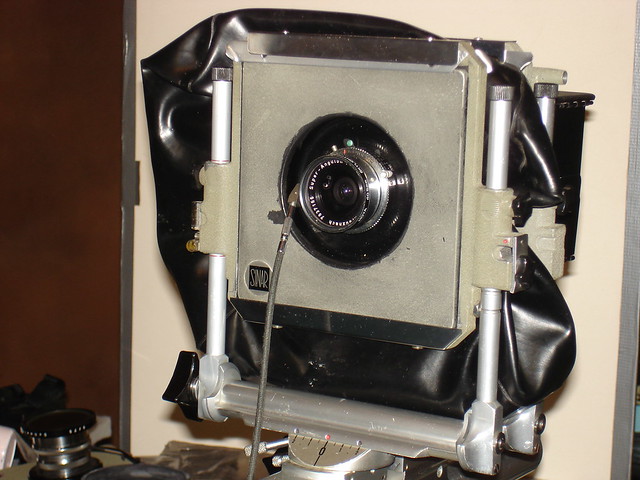

I've backpacked many thousands of miles with Sinar cameras, under all kind of conditions, including mountaineering and canyoneering use - real torture test applications, as well as for studio and architectural usage. With an 18-inch rail (I like long lenses), my 4x5 system is just one pound heavier in the Norma system versus the F2 version, but it's a lot more solid. The later F cameras have smoother locks and gearing. Forget the old F+; it used an inferior intermediate standard as the front standard. P's and X's are beautiful machines, but unduly bulky for field work; and all that extra weight equates to the need for an equivalently stronger and heavier tripod support. So overall, the original Norma is my favorite Sinar series of them all. The lack of yaw-free controls is insignificant. It is a helpful feature if you are routinely doing tabletop photography in the studio, where intersecting planes are predictable, but generally of little relevance in the field. Monorails like this are extremely versatile in terms of the range of lenses they can accommodate, and quicker to set up than folding cameras. I do also use folders for sake of maximum portability, like airline travel or now for long-distance backpacking. But the Norma is way more convenient in actual use, and undoubtedly more durable too. It's also modular in terms of switching out components and potentially being multi-format. The sheer quality is also apparent; you just don't see that level of machining anymore; it would be prohibitively expensive nowadays. It's all the real deal - no CNC anodized aluminum. Everything can be user fine-tuned. Highly recommended.
002 by Nokton48, on Flickr
One last image. Since you are doing architecture, you are concerned about moves/wide angle photography. The Normas excel at wide angle photography. This is a 47mm F8 Super Angulon and I can do all the moves I need to with this lens. A considerable advantage.

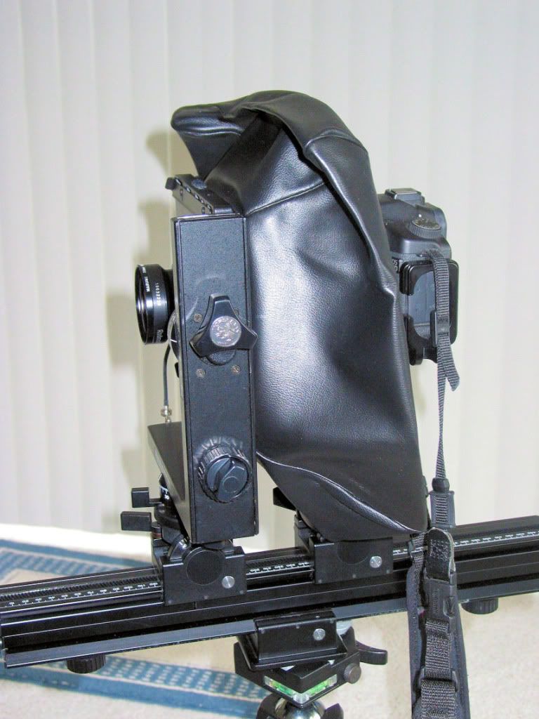

For your Sinar you could seek a Horseman bag bellows, as the Sinar and Horseman accessories that fit the standards are interchangeable.
Here is a photo of my Horseman with bag bellows, with rear plate adapted to mount a digital SLR
