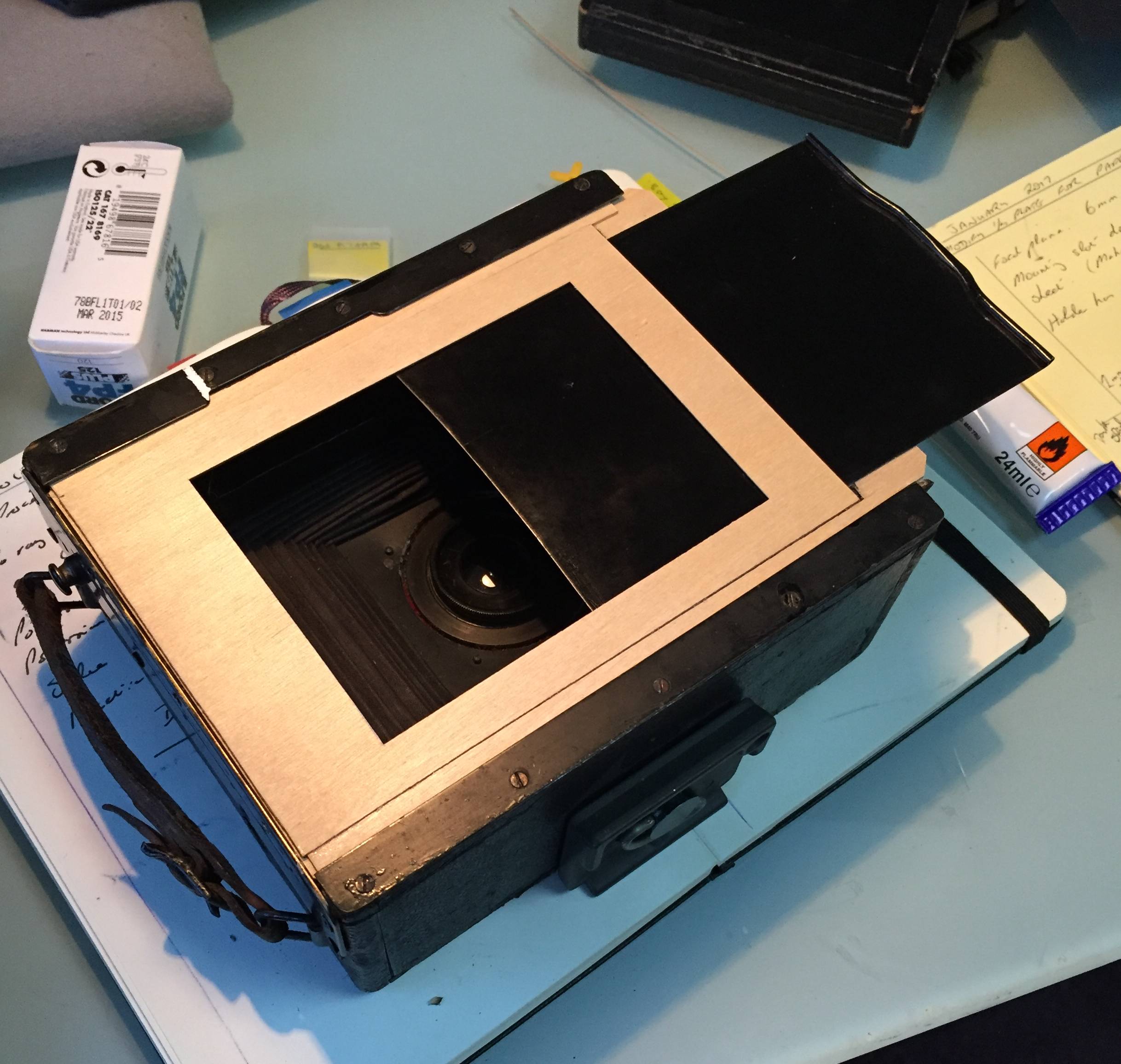

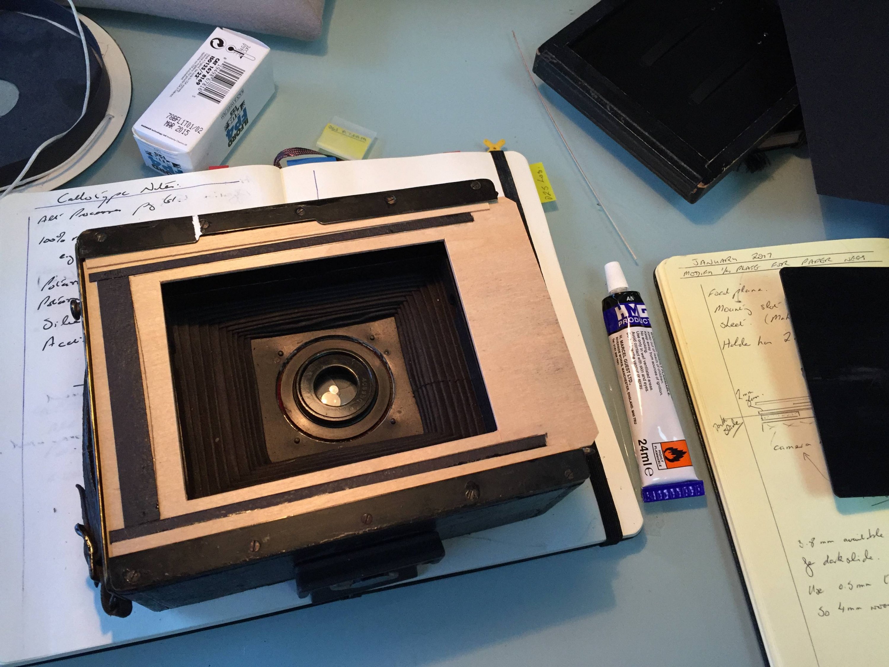

1) Busy making a prototype paper neg holder for my quarter plate camera. Using a commercial tin darkslide for the prototype.
The focal plane is some 6mm above the rear flange on the camera so I've currently got some 2.5mm to play with. I can either stretch the neg bare across the window in the holder or I can install a 2mm glass plate to create a sandwich. I understand that the glass option was how this was originally done, with the neg between the glass and a backplate.
Any views or suggestions?

Hello Simon,
not to steer you away from asking questions here on APUG, but I think the Calotype Society is really the place for getting answers, good ideas (and excellent calotypes): https://www.flickr.com/groups/1384661@N22/
Forum member NedL has done a lot with calotypes and if I recall right has experimented with gallic acid.

Hi Simon,
Are you going to use commercial photo paper in your camera? In that case we usually call them "paper negatives", and use normal paper developing like for making a print under an enlarger. If you search for "paper negatives" on APUG you'll find there are various ways to help control the contrast ( pre-flashing, using a yellow filter with VC paper, using more dilute developer, etc.. ). But you can get started without all of that. No gallic acid and you don't need to sandwich the paper between two sheets of glass. It is important for the paper to be flat, just like in any film holder, but I haven't heard of anyone using an extra sheet of glass for that purpose... the rails that hold the paper in place should work well for small paper negatives like you are making. A piece of tape will probably solve any flatness problem, but I doubt you will need it. It becomes harder to keep the paper flat with big holders like 8x10 or 11x14, just like for film.
We sometimes reserve the term "calotype" for paper negatives that you make yourself with potassium iodide and silver nitrate ( +/- other things ). I think if you were planning to do this, you'd already know the answer to your question, which is why I guessed you are making commercial paper negatives. Gallic acid is used to develop calotypes. Talbot's earliest calotypes were a kind called "pre-silvered", and he used a small amount of gallic acid during the first step in making them too -- which caused trouble and was left out by later calotypists.
Two main kinds of calotypes are wet and dry. Wet calotypes are used while the paper is still wet and go bad if they dry out. By putting them between two sheets of glass, you can gain a few hours to use and process them, and also contain the mess from getting all over the inside of the holders and camera. Most dry calotypes can be used up to a day or two after they are made, and were not usually sandwiched between glass. As a practical matter, some people build holders using the glass sandwich because they can be used for both kinds of calotypes.
Have fun!
Hi Ned
Plan is to make the 'dry' type (silver iodide) on cotton based paper and develop using the chemical used by Fox Talbot.
I have plenty of 2mm glass so I'm going to start with the glass sandwich type holder.
I'm starting quarter plate and already shoot whole plate so I can move up later.
I've just discovered how expensive gallic acid is here in the UK! (£73/100g)
I already salt print.
I'll post up any results (good or bad) for your review.

Hi Simon,
Sorry I misunderstood! The glass "sandwich" type holder would be useful if you ever decide to make wet calotypes, so it seems like a reasonable choice to me.
£73/100g does seem expensive to me, about 3x higher than here. Gallic acid can be a little difficult to get into solution. It doesn't need to be saturated: a 0.7 or 0.8% solution will work fine. I usually make it in hot water in a plastic cup, stir for a few minutes until dissolved, and then put the cup into a larger one with ice water to cool back down to room temperature. A more convenient option is to make ~20% solution in ethanol and use that as a stock solution, but I haven't tried that yet.
I don't know what formula you will be using, but I use one where the sensitizer contains about 6% acetic acid. Even though that is only a little stronger than vinegar, it always irritated my throat. I purchased an acid gas and organic vapor respirator ( which specifically listed acetic acid ) and now I can't even smell it. The one I found was the 3M 60923 and it was available in the painting section of a local hardware store. That might be something to look into if you plan to make quite a few calotypes. My only other advice is that paper is critical and some papers will not work without acidification.
Good luck and have fun!
