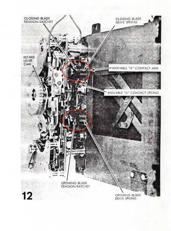

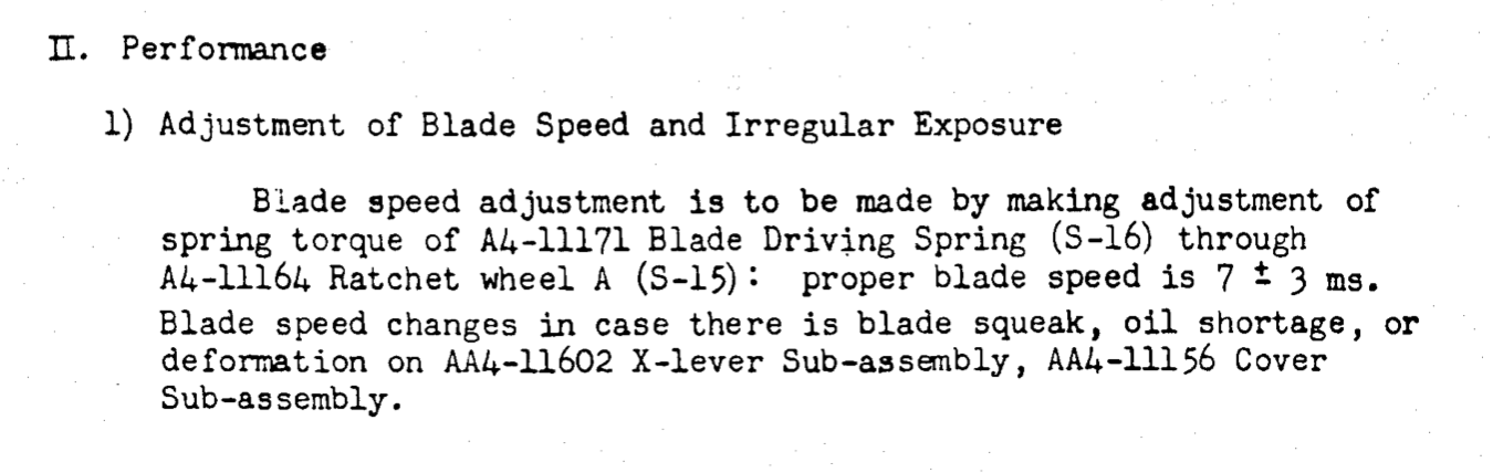

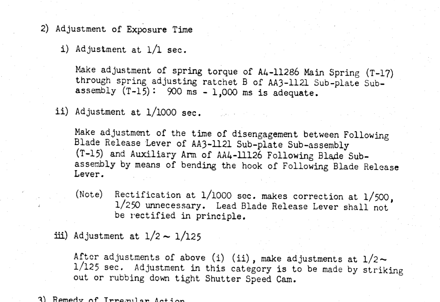

Attached documents may be of some help. Do you know the shutter transit times?
No I didn't write them down. i do recall 1/1000 was about 1/500 and 125 was 1/85. 500 was more like 1/300 or slightly less. I notice in the 3 attachments you posted that it calls for a single adjustment for everything between 1 sec and 125. Problem is that everything from 1 sec to 1/60 was perfect. Logically thinking, 125 could probably be pulled closer to spec by making the 1/1000 adjustment., and leave the 1 sec to 125 alone. I'm just not familiar enough with the Copal Square to even know how to do the 1000 adjustment. How to gain access to it, when it is still mounted in the body. I do not have a jig to mount it in, so that I could cock the shutter as needed. It has to stay in the body so I can use the film advance lever. Now the entire camera is 100% reassembled and the leather re-attached. Since I have 3 newly CLA'd Nikon F's, I'm thinking "what's the point"? The sales value of them is so low I doubt I could stand on a busy street corner and give them away. Kind of sad, really. The Nikkormat was a far better amateur camera than the Pentaxes, Olympus, Konica, Minotlta, Miranda, Yashica and the rest.
Actually, it is the shutter transit times that need to be adjusted first. By adjusting the spring torque. The correct value from the manual is 7 milliseconds.
Yes after making this adjustment very likely the speeds are very much better. This error would cause more percentage error on the high speed (because it caused an absolute error in term of time).
