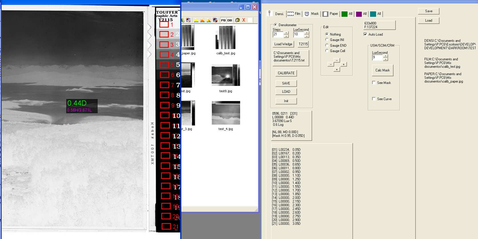

Why not just get a Stouffer wedge and scan along side your negative? This is what I do.
I made a Freeware that I'm to release for that, it provides very accurate values, calibrated densities for the Stouffer's patches can be entered.
Scan the negative alongside the wedge, click on first and last patch (to shot the red rectangles) and then you point with the mouse to any spot and it says the density.
If you set the Lux·second on the exposure the enlarges is to perform (Lux on the easel without the negative multiplied by exposure time) then it says the exposure on paper for each spot in Lux·s and in H-Log units
It also makes the film and paper calibrations (curves), so it calculates the mask and adds the maask to the negative as if it was a new negative, calculating the paper image.
Instead refining a version to be released I advanced too much in new fectures, like proofing the tring with a color contrast mask, but I plan to stop development to make a distributable version with the basic features that are working very good yet.
Linear scans are not necessary as the non linearity also is played on the wedge, so it works the same, anyway I want to add TIFF 16 bits/channel support that it presently lacks to take full range scans.
If someone wants it I may send it to him, it would be good to have opinions, but he should provide an Anydesk or similar conection to tecah him how to use it

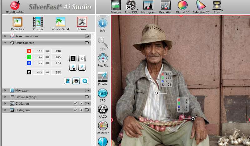

Epsonscan also has a densitometer reading. I've never used it so I don't know how accurate and effective it is. Maybe someone else has and can give some details.

This tool tells the R-G-B values of the scan, but those values are not the the sensitometric density in the negative. Anyway if you scan a density wedge with the film then you may locate what patch is close to the spot in the negative.
Silverfast also has a similar tool:

It your 16 bits/channel scan takes all the histogram and later you adjust curves in Photoshot, then it is not useful.
Instead, if you craft yor image directly in the scanner software, by adjusting clip levels and curve with it... then you may read the values of the pixels in your image to know if you are clipping highlight or shadow detail, for example.
Personally I do not use much those tools, as I work all images with Photoshot, it may bve useful with images in wjhat you not want to waste much effort on them, and you want just to obtain some decent final image from the scanner sorftware, not wnating to edit later with Ps, etc.
Doesn't checking the histogram accomplish the same thing? Why would you want to look at specific pixels when you have the histogram?
Not the same, with the "Densitometer tool" you check particular areas in the frame to see what reading you have there. May be you want to allow clipping in certain areas of the scene but not in others.
How do you allow clipping in specific areas?
Well... you don't directly allow (or not ) clipping in certain areas, but you can check with the "Epson_Scan RGB densitometer tool" if the levels you set provocate a clipping in certain areas.
Of course, this is useful when you mostly adjust the final image in the scanning software, if you are to work the image in photoshop then you usually take all the histogram in 16 bits/channel and you clip nothing, you take all the dynamic range the negative has to keep all your options open for your future edition. Of course that image will be dull and very flat, and it will require a curve edition in Photoshop or Lightroom...
The dynamic range the negative has recorded from the scene can be well larger than then one a monitor or a paper can show, so to show mids with a suitable gradient (like in the scene) you may have to clip extreme shadows and highlights or you will have to compress extreme shadows and highlighs to take not too much range in the diplay medium or device: to allow the mids be contrasty enough.
You can do that job in the scanning... or you can take all histogram and later adjusting curves in the image edition software which is what we usually do for important images.
