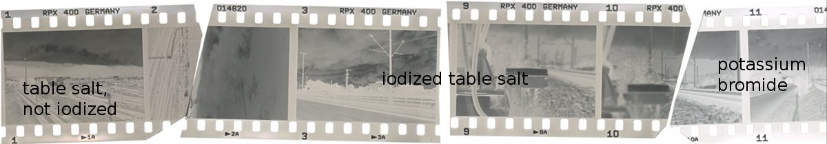

When I'm doing LOW-TEMP stand developing for age fog reduction, I have worried more about it, but again there's only so much I can do with the current facts of my life (aka developing in the kitchen).
I use 1-2 gr per litre of Kbr (potassium bromide), it helps a lot in full stand, even with low speed films (100 ISO), it clears up the negs. Iodized, or not iodized, salt are far less effective. as you can see here :
