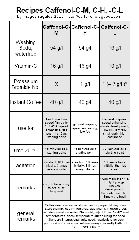

Here are the recipes I use and aways get great results. I also use pharmaceutical grade 100% vit c as well as chemical grade chemicals for the rest of the ingredients. Not stuff purchased at the grocery store. Only buy my instant coffee from grocery.
Thanks for the handy chart. I'm going to print this for my darkroom wall.
Thanks - that's the chart I used, from the "Caffenol Cookbook" - however, I went for the "RS" variant, with somewhat reduced soda content...
But, my chemicals (vitamin C) might be off: like I said, there was no foaming when I poured vitamin C powder into dissolved soda, so...
However, since I already have both Rodinal and Xtol (plus some other tried and tested developers), I don't really see the point: besides, the smell definitely puts me off. Doesn't smell like a darkroom at all :blink:
