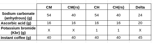

I looked up the Delta recipe and read your article, thanks (google translate works .. kinda 😁). For convenience sake here's a quick chart :
Caffenol recipes for 1000ml
References :
I guess it's all relative. CCM/H can be considered hot compared to other caffenol recipes like Delta, but it's not as active as, for example, XTOL stock (5-6min for fomapan 100 at box speed). Delta is not much different than CM/CH regarding the quantity of ascorbic acid and instant coffee, but went the route of a significant lowering of sodium carbonate. I guess it lowers the PH below 9 and render the mixture much less active. But why lowering the wasing soda so much while keeping Vit. C (not cheap !) and instant coffee to somewhat high quantities ? the article I've found (see references above) didn't explain much.
In your article (https://blog.erdmenger.de/2023/09/01/artlog-architekturfotografie-und-caffenol-push-entwicklung/) you explain that CM was better than Delta for a 2 stop push, but also note that the extended developement with delta was barely enough. It would be interesting to compare the two recipes using developement times that gives the same density in the highlights.
In the meantime, my working theory is that the caffenol C recipes don't matter much as long as there's enough developing agents and the PH is in a given range (8-10.5 ??) : the same results can probably be achieved tinkering with the quantitites of each components or using the developement time as the only variable.
If we divide the 15min CM/CH-time by 1.44 we get around 10min for a box speed development with this very receipt. Interesting to see that you even need to down the time to 9min …
Interesting indeed that the 1.44 "rule" applied to CCM/H 15min starting point gives 10min, that's pretty close to where I'm at. As Donal Qualls pointed out, difference in agitation scheme play a role, and I'd add that we all have our personnal preferences regarding how dense we like our negatives. I usually print at what should be a grade 3 on my color head so I'm not a fan of high contrast ones. But this remark encouraged me to try a developement right away with CCH(rs) using real shots, 9min at 20°c : the negatives are drying right now and they look good :smile: I'll try a quick scan and maybe a print tomorrow.

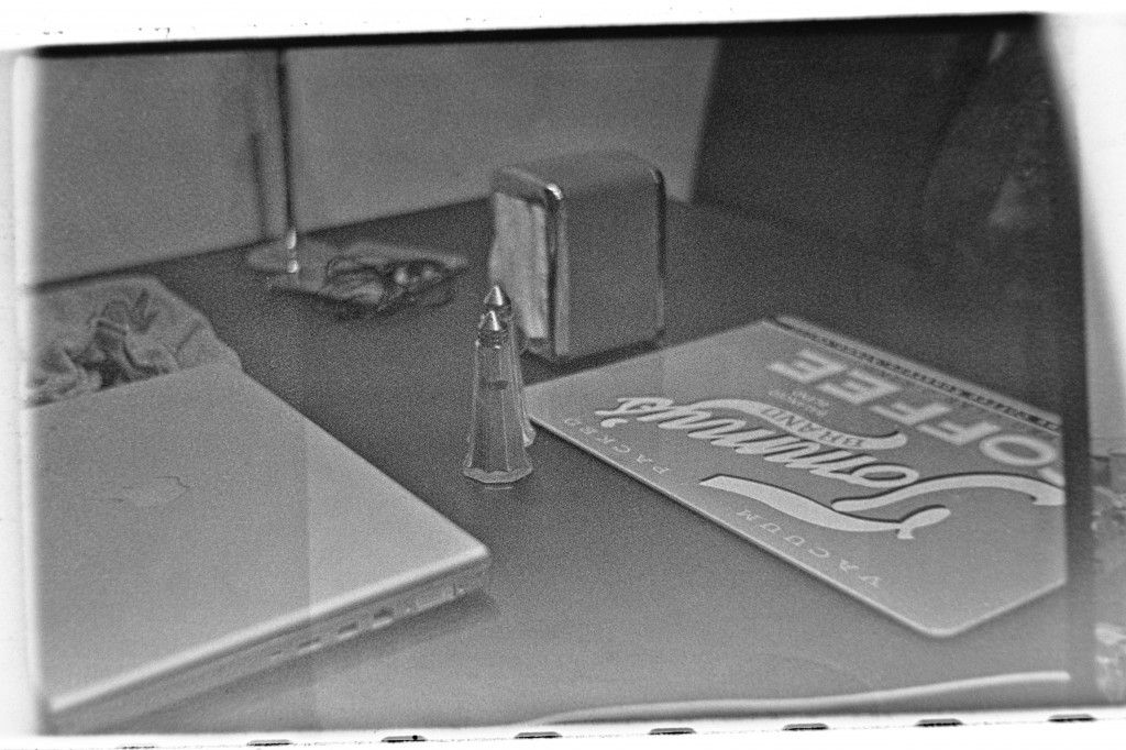

Just to post a concrete example, here is a picture shot in K400, exposed at ISO 800, and developed in Caffenol "P1":
This is a direct scan from negative using a 25Mpx scanner, the only digital processing was a very minor contrast adjustment in Darktable. I musyt say I am really pleased with the results, overall. I will probably be able to provide a direct comparison with Mytol on the same film and same shot, as I might have the chance to go to the Natural History Museum again in the next few months. For what I have seen so far, Mytol might allow to get a tad finer grain and a bit more acutance, but I really like the results I got with Caffenol P1 overall. I will try it with K100 as well, very soon.
Thanks again for sharing the recipe.
