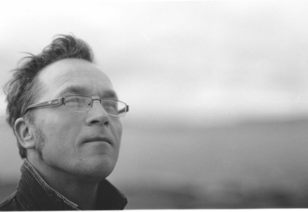

But here's a scan of an A4 copy I made last night.
Both film and paper developed in Caffenol. Softness is due to the lens (Nikon 55/1.2 wide open) and focus being a smidge too far back.
The dust is from the last scan, the paper copy is clean.
I like this.
PS nice picture, I like the slight soft effect, and the extreme placement is excellent works well with his eye-focus.

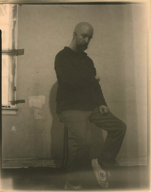

I have done a Coffee develop, and really really really liked the results..
The film was developed in Diafine 3+3 (Adox CHS20) and the print on Agfa RCIII 8x10 paper.. The paper took the staining wonderfully, which is why I used the Coffee developer.
err, you'll have to pardon the left side of the image.. That's my fault.. :smile: A little over-zealous with the paper..

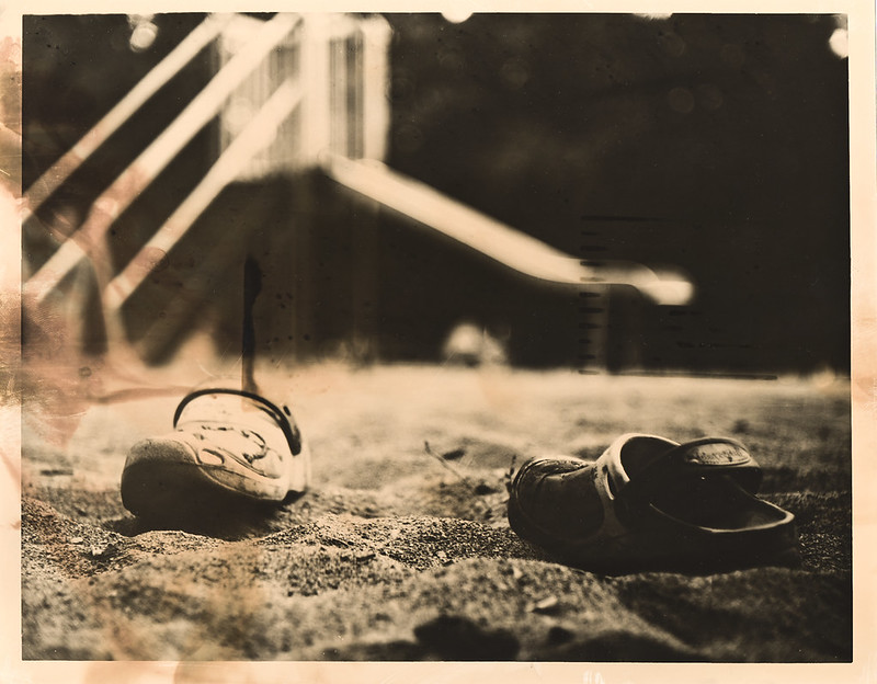

By the way, here's my result. I haven't done any more extensive testing, sorry to say, but I do plan on doing so soon. Not a great shot, I know, but I was aiming for just a quick and dirty test.
2013-02-21CA-001 by Terry Christian Photo, on Flickr
Great start, Terry! Is this the DPP?

Yes, Tom, this is the Ilford Direct Positive, and I believe it is FB glossy. I'd had this paper already loaded in some film holders for a few weeks before I made these tests, so I don't know if that has some bearing on the pinkish tinge or not. Overall I'm rather new to printing and did no printing at all most of last year, but with warmer temperatures creeping in here, I'm determined to do more, and I'm just now discovering the possibilities and the look of caffenol. Good to make your acquaintance on Facebook as well!
