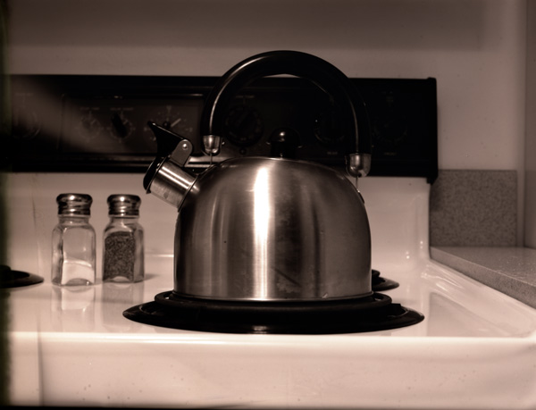

Here is my first ever Caff developed shot. TMax 100. I used the same formula you did, didn't have any Vit. C yet. I was fairly pleased, but have to admit any image was a pleasant surprise to me. :smile: A couple of subsequent attempts, though they produced printable images, didn't impress me as much.
