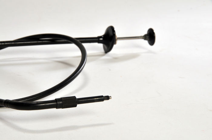

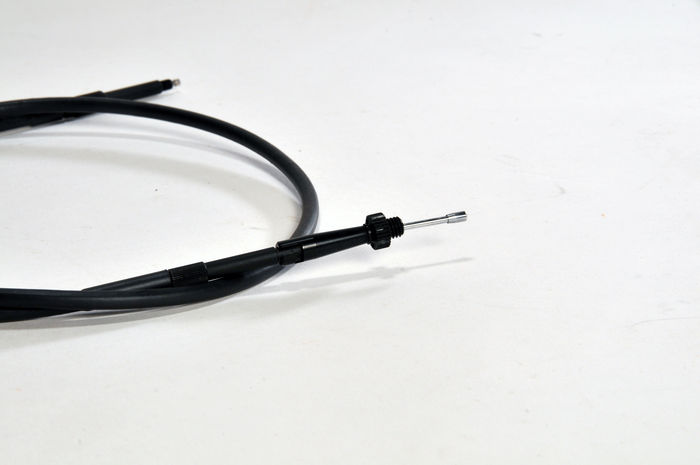

Ok, maybe I'm just being dumb, but are there different length pins on shutter release cables. I'm not talking about length of cables, but the pins which extend past the screw in collars...
I got a new camera and when I screwed in my current shutter release cable it's pin is too short to trigger the shutter.
Are there different standard sizes? Which type is the longest?
I just looked at 3 different cable releases I have, must be three different brands likely made years apart, all have different pin lengths, in my small samples the longer the cable the longer the pin.
Cable releases are standardized, there is a minimum plunger extension defined.
Well, a manufacturer of shutter or release may have not adhered to such standard
Some releases offer to adjust plunger extension, one has to check such first.

The standard is 9.5mm minimum extension (effective throw).
Schreck state for their cable relesases a 19mm throw.
