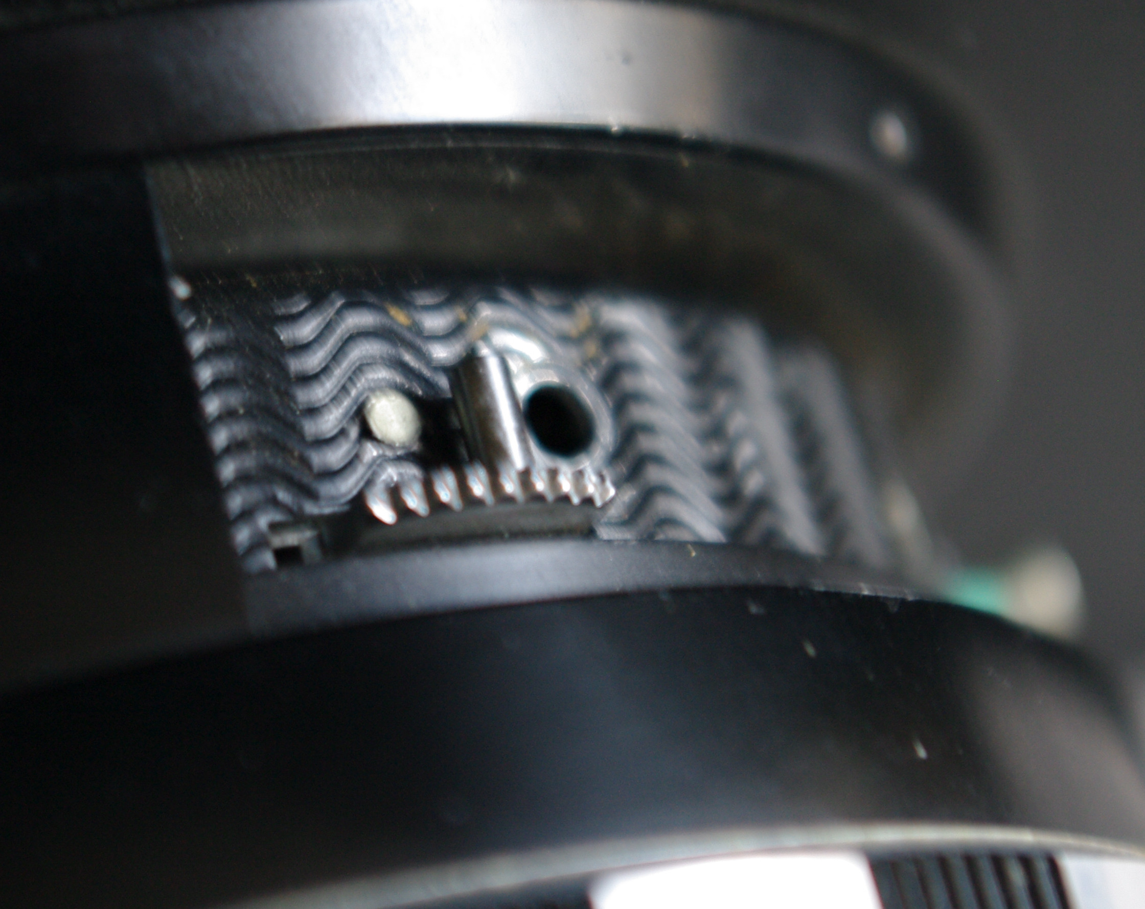

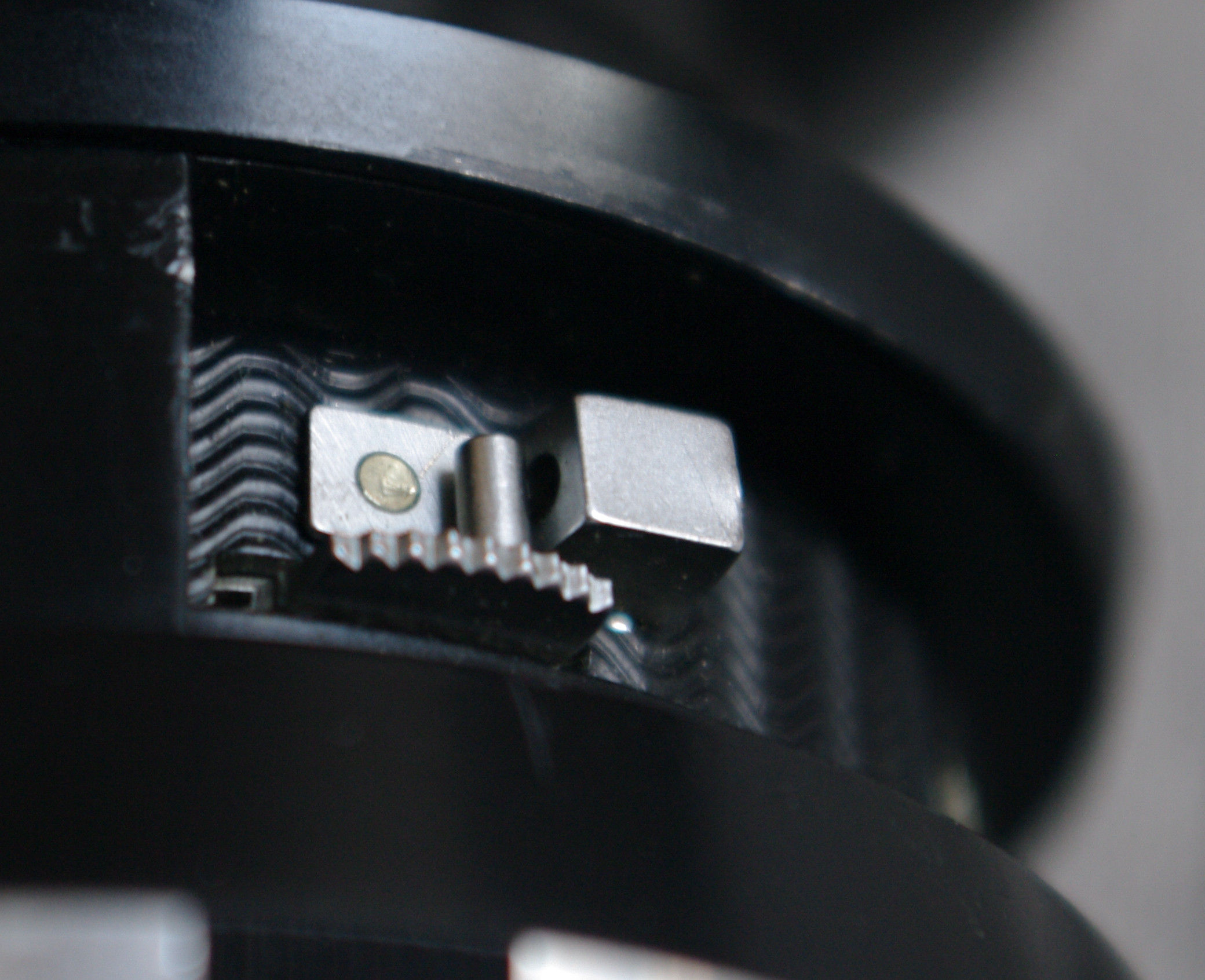

One of my lenses is missing the threaded receptacle for the cable shutter release from its Synchro-Compur P #0 shutter. (It's the kind that's a block of aluminum with a threaded hole in it, and with a thin lip sticking out at the bottom, which goes under the shutter release lever, and is held by a plug that looks like it's an interference fit, or possibly is expanded by hitting it with something after fitting the receptacle.)
Of course, it can't be properly replaced without taking the shutter apart, which I'd rather not do if I don't have to, so I have two questions for the grown-ups on the forum:
1: I was thinking that a couple of tiny drops of judiciously applied epoxy cement would hold the part well enough -- after all, it's not as if there's much force applied to it. Does that sound reasonable?
2: Any tips as to where I can get hold of the spare part? I'm watching eBay for defective S-C shutters sold for parts, but it might take a while...

Looking at a working copy it looks like the socket is held by a blind rivet. I doubt epoxy will hold it for any period of time unless its never used. A piece of brass or aluminum rod pressed in would be better. The socket may have a pin on the threaded end to prevent it from turning.

I've actually got two of these lenses: one badly damaged one, but with a very good shutter, and this other one that has a somewhat more worn shutter, with the missing cable release receptacle. I'd like to move the good lens parts over to the good shutter, but unfortunately it's one of those lens constructions that wrap around the shutter quite a bit, and to take it apart, I'd have to get the front element (the actual glass) out of the aluminum flange holding it (to get at set screws hidden inside the lens, locking it to the shutter so it can't be unscrewed), and I can't budge it. The front element on the bad lens just dropped out after I unscrewed the front ring, which turned out to be holding it pressed into its flange, but on the good one, I've even tried pulling rather hard with a soft suction cup, to no avail. I've sort of decided to leave it at that; so far, I haven't damaged the surface at all, and I'd rather keep it that way.
Anyway, I thought I'd upload pictures of the area in question on each of the two, just so it's completely clear which type I'm talking about...
