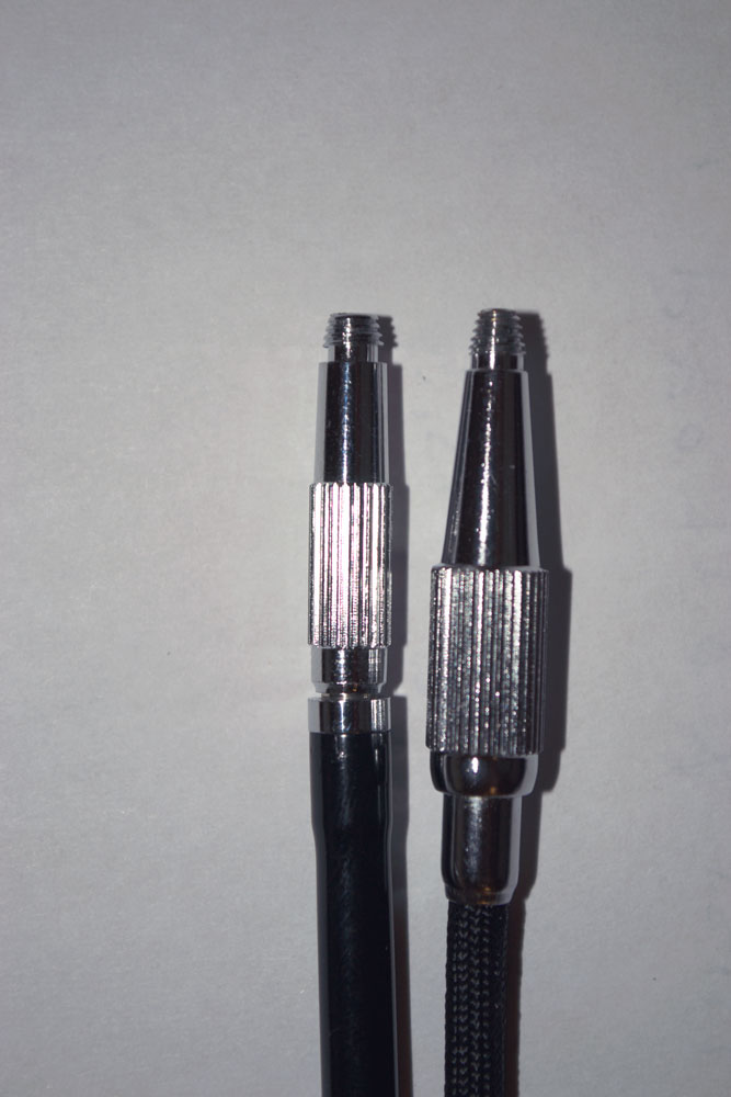

In an attempt to make my life easier I bought a cable relase for each of my LF lenses. The idea was to attach the cables to each and leave them that way in my camera bag, ready for use. It turns out that some of the cables frequently came loose, and even fell off the shutter. Upon close inspection, it was clear that not all the cables had the same number of treads. The picture shows the one on the left (the generic brand) with a much shorter thread than the Nikon cable on the right. The Nikon never leaves it's shutter. Did I just happen to buy some defective/really bad cables, or do I need to ask about the threading before buying? Which cables to you use/recommend? I didn't think this would be so complicated....

The Nikon AR-3 has a long throw, plenty of threads and is the only cable release I use anymore. It has never let me down and is worth the premium price. The new AR-3 has a plastic shaft by the plunger, but seems to be otherwise the same.

The throw required to trip the shutter can be a factor, which is why I have tried out cable releases for my Pentax 67 prior to purchasing, (also ZeroImage 6x9 pinhole), but your problem seems related to the nipple threading and typ. Of the two releases you have, the one on the left is a design I've never seen before, while the Nikon on the right is the more conventional. I use a beefy Hasselblad release with a taught plunger and moderate throw. Previously I used a slender and tiny German cable release with a slightly longer throw (not a problem) — just fiddly to hold onto. I checked as a matter of fine detail the nipple and threads on each release. All releases I have (there are two) will also fit my old Komuranon 90mm f5.6 fitted to a home-made 6x17. So I would surmise the problem is in the design of the cable release thread/nibble: stick with the traditional nipple design, as the Nikon shows. Steer clear of el cheapo chinese releases: the quality control can be just atrocious. Mind you, many (including me) baulk at paying $80 for a big-name release but you'd be surprised how spectacularly smooth in operation and fitting accuracy they are.

I'd keep an eye on the Nikon release, there are 2 lying about in the undergrowth many miles from here, both fell out on different occasions. And they are not cheapies.
