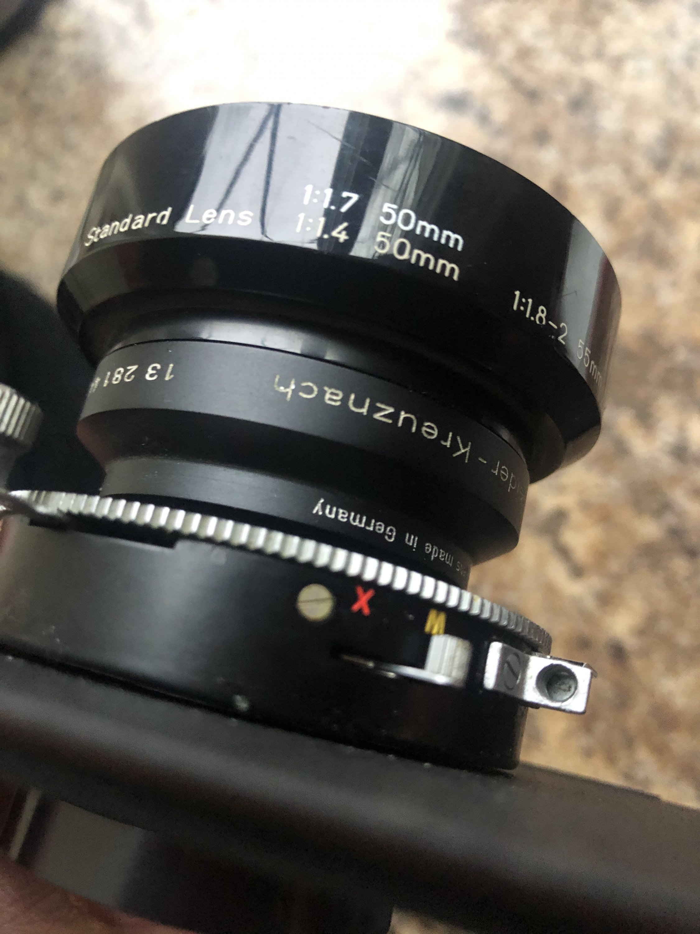

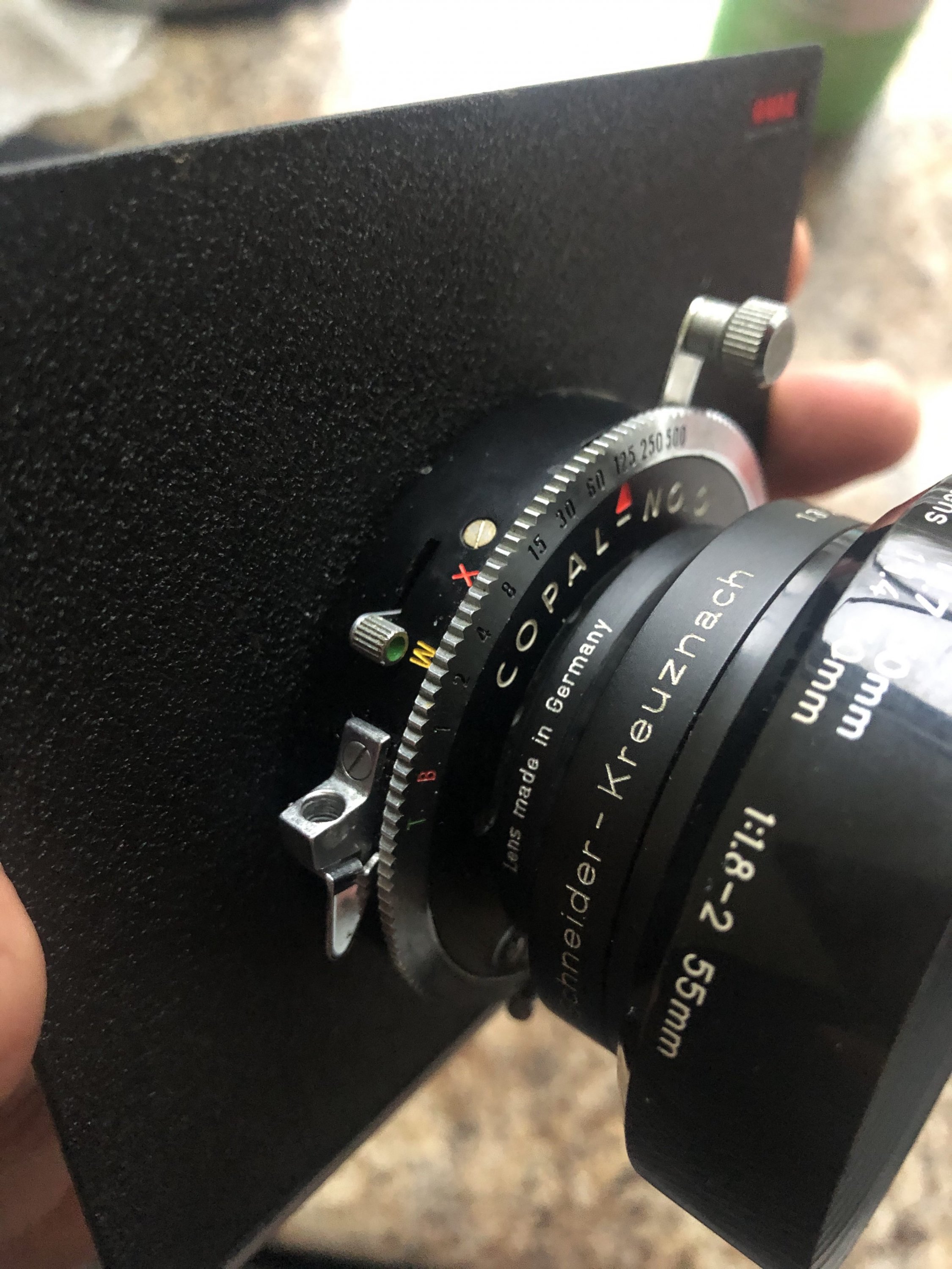

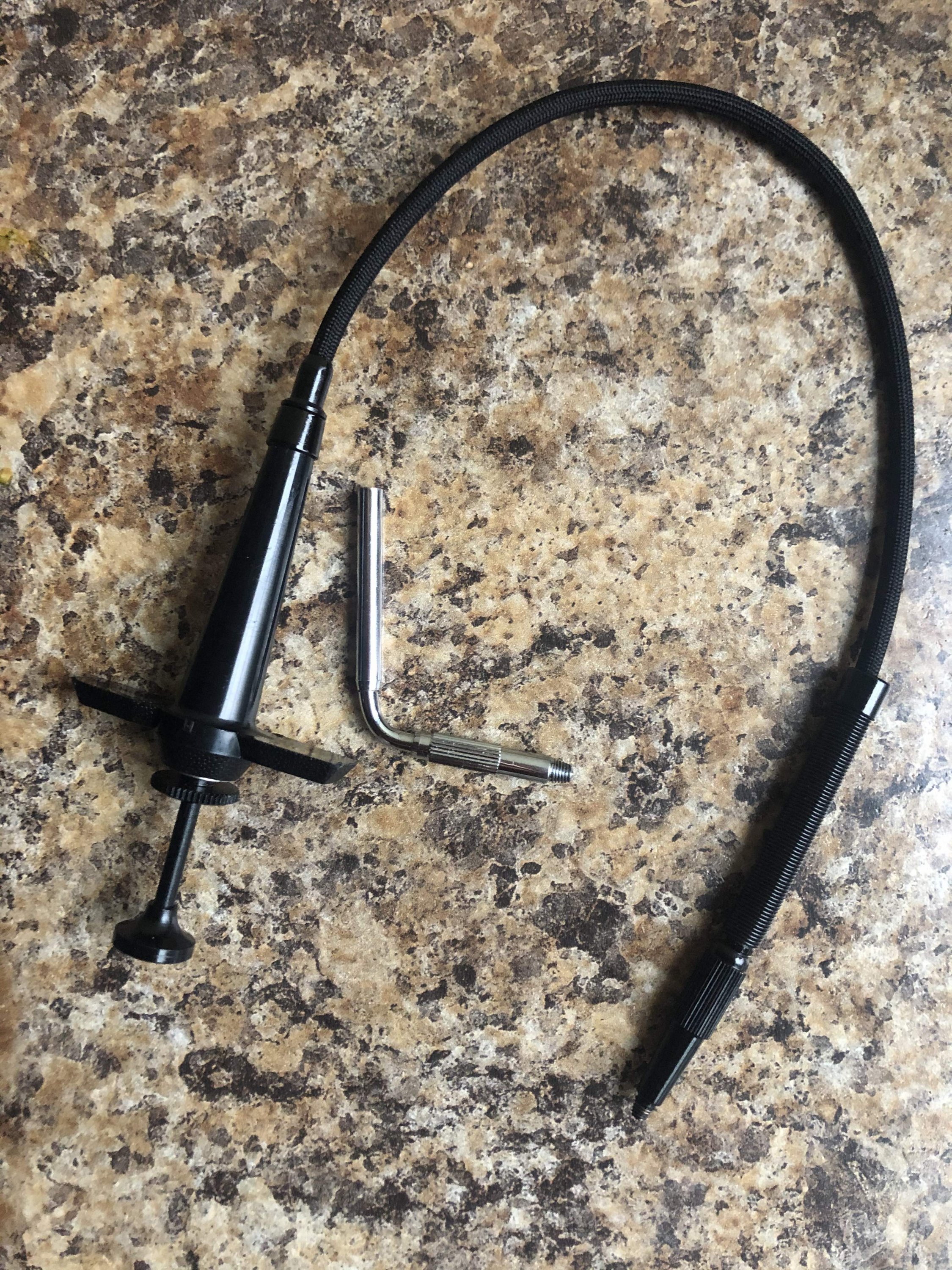

Kumar, apologies for the late reply. Here are the components in question. I received the shutter with the lens attached. I imagine that the socket is just in fact stripped.
The outer threads seem to be stripped. Otherwise it looks fine.
That socket is easily available as spare. Otherwise sent it to a camera repair shop for recutting the thread.
