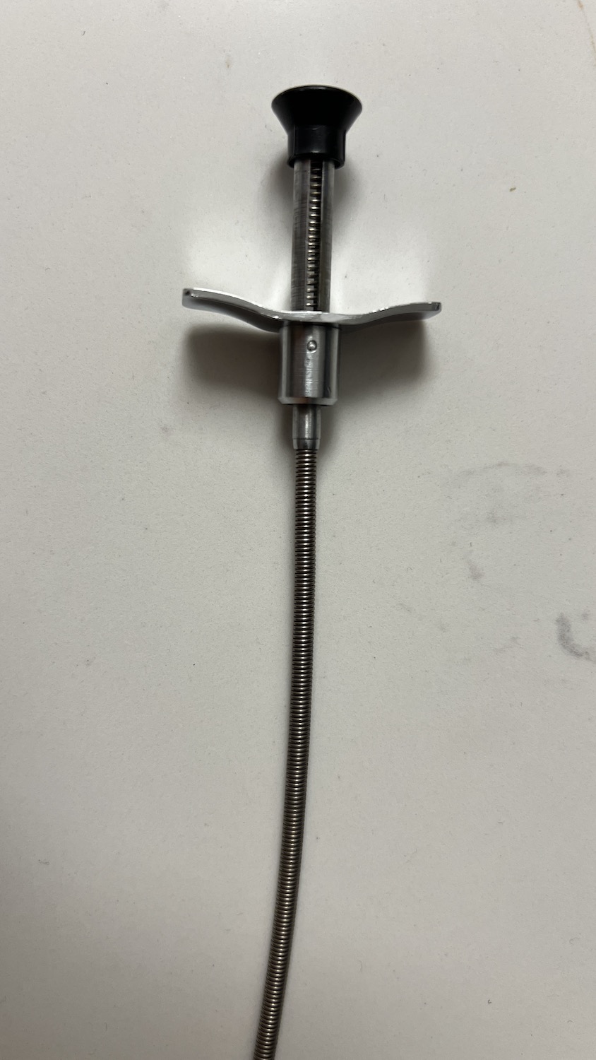

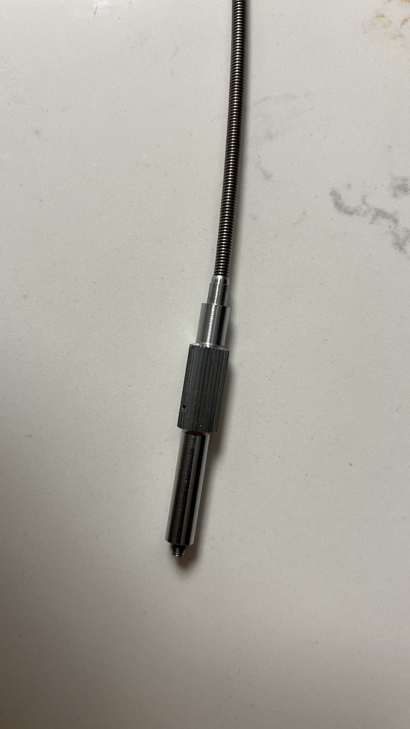

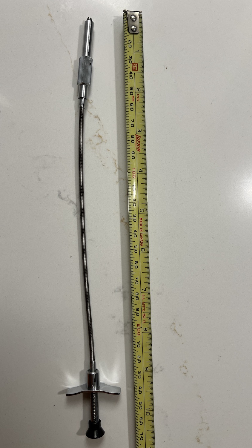

Original cable release supplied with Kiev 80. It's really heavy duty, but also your camera maybe needs CLA.

I have tried tripping mine with a cheap modern cable release and it’s a no go. An older one I have has both a longer pin and can push a bit harder and it works fine. Let us know how the CLA goes
