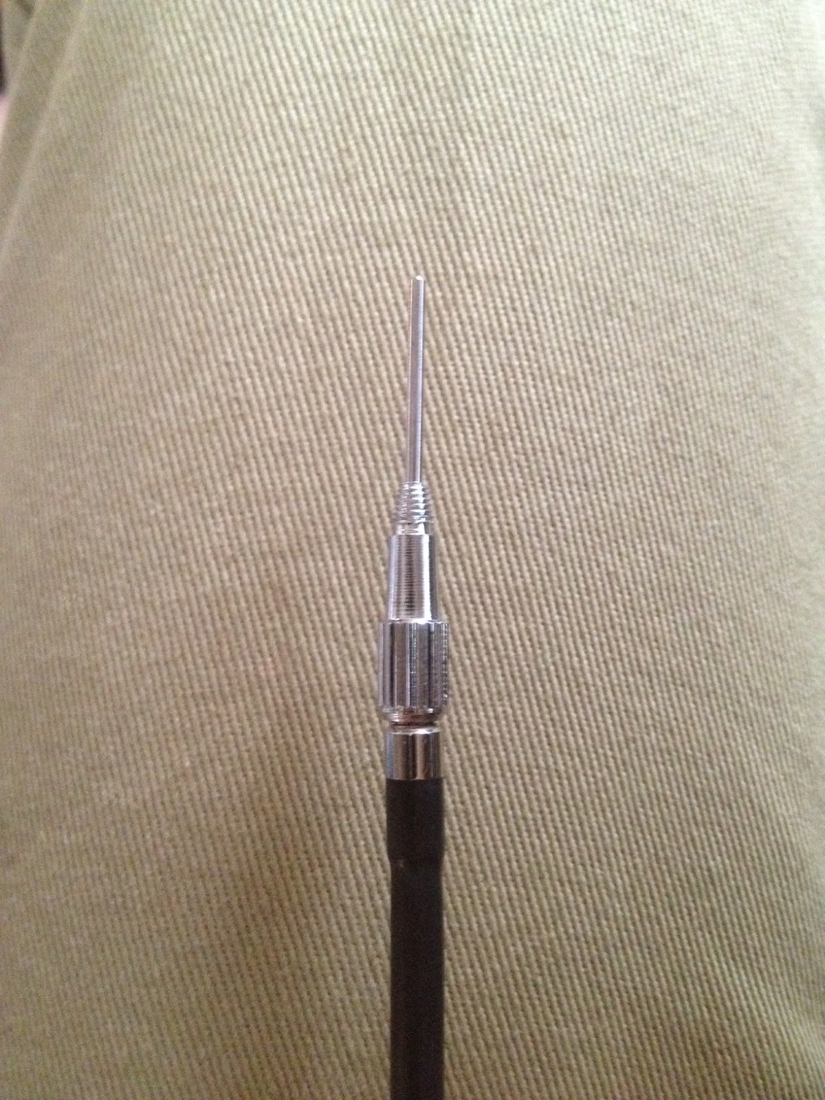

I lost two cable releases last week on the same excursion - inexplicably, both my mechanical release and the silly little plastic thing for my DSLR escaped me. I'll never understand how that happened, but anyway...
I've bought two new mechanical releases for use with my medium format cameras. The first one had an extruding wire, dangling about an inch from the thread, bought a second one from a different online store and the same thing:
http://3.bp.blogspot.com/-LwuNgSJx9uE/UEo0r6kLCCI/AAAAAAAAAQA/oLOt8FVNVFU/s1600/photo%2814%29.JPG
The item description clearly stated they were universal mechanical releases, but I'm unable to attach them to my Hasselblad or Pentax 67.
With the one I lost, the wire was only visible upon pressing the button - popping out about a couple of millimetres.

At the top of the cable, the button you press in?... is it in the locked position, thus the reason the wire is extending all the way?

How embarrassing... I've unlocked them. First time I've used this style of release, my last one didn't have a lock thread or extrude this far. Cheers.

The circular locking knob is called a brake (or lock). Be careful you don't poke yourself in the eye getting a grip on these nasty things! :smile:
Whenever buying a cable release for the Pentax 67, take the camera along and fit the prospective release, as the shutter throw on the 67 is deep. I had a German-made release last November that bottomed out without firing the shutter. An humungous, clunky release from Hasselblad (curiously, Made in China...) did the trick, though I protested long and loud at the atrocious cost. Meanwhile, I've never lost the 60-T3 electronic release for my EOS1N, bought in 1994 and still firing.
