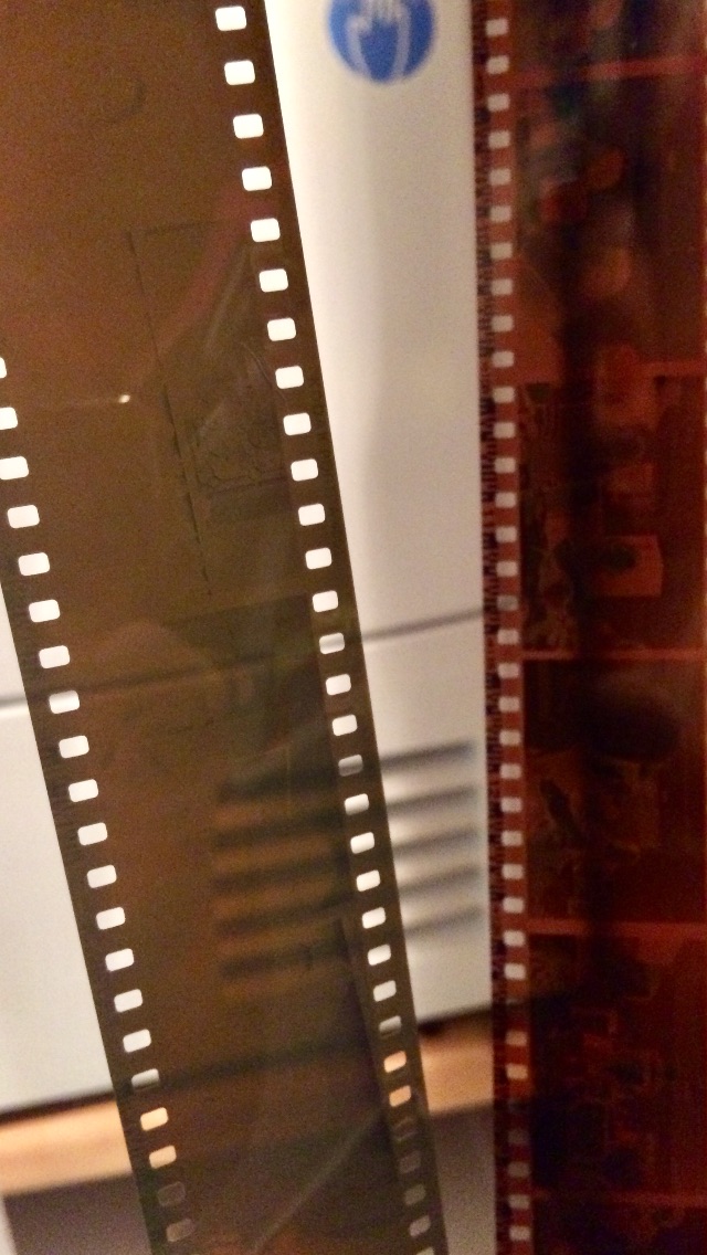

I’m looking for some help as to what I’ve done wrong tonight processing two rolls of C41 (i’m fairly new to the process)
Mixed up fresh chemicals - Bellini C41 1 litre kit with separate bleach and fix.
1st film (Superia 200) processed absolutely fine, strong orange base, good contrast, strong edge markings.
I washed out and dried the tank, re loaded and went again
Exactly same process, temp, agitation (I am using an automated processing machine)
2nd roll (Portra 400) - extremely thin, barely developed, little colour with a murky brown base.
I’m not sure what went wrong! The machine pumps the chemicals back into their respective chambers, and then runs the same sequence again, so I definitely didn’t mix up the stages.
I’ve tried re bleaching and re-fixing but no difference.
Any clues?

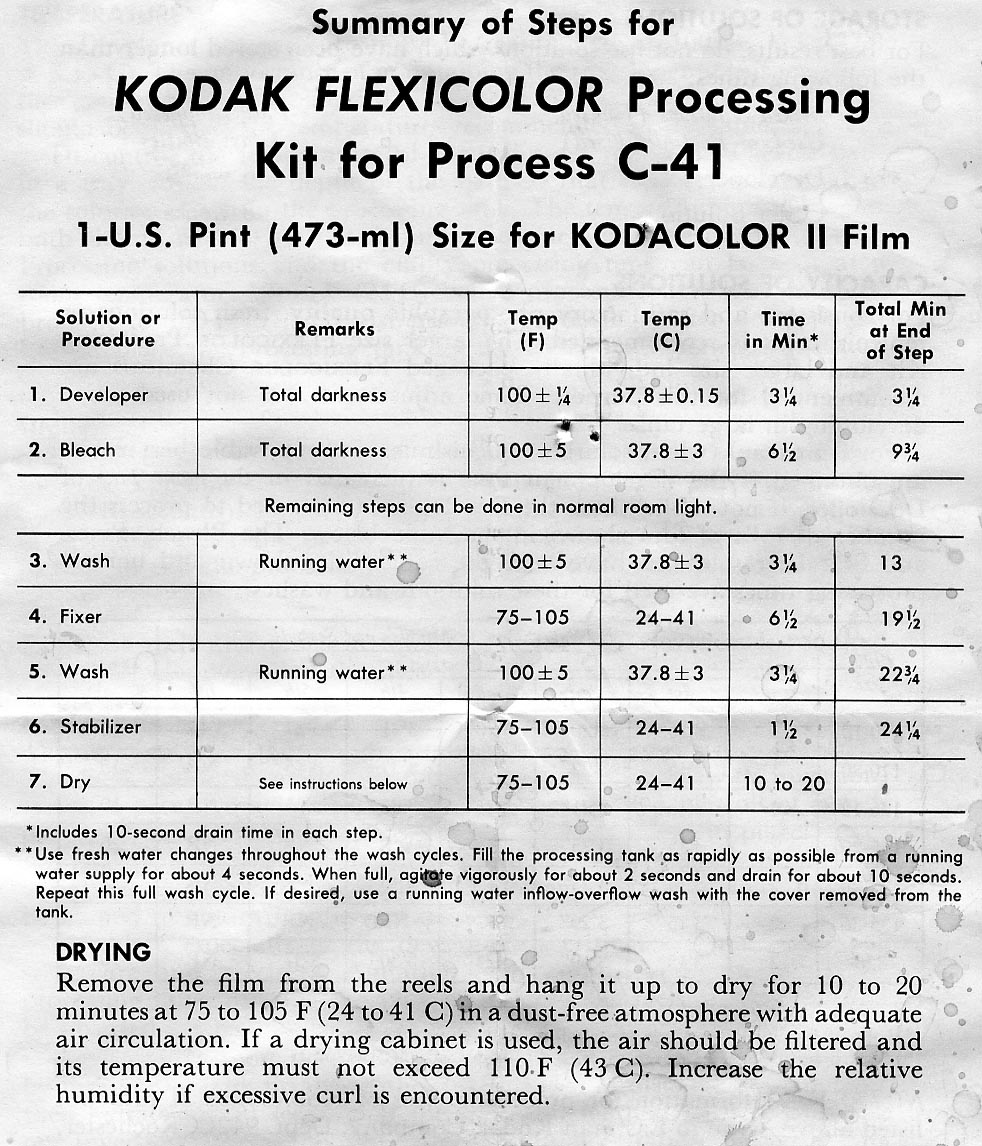

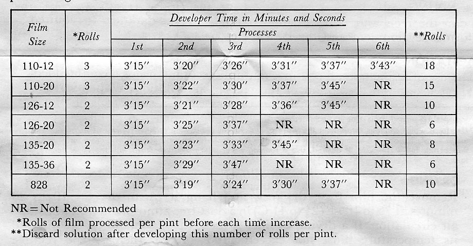

Here are the Kodak recommended process cycles and capacities for C41 authentic chemicals.

The instructions you quote are from a RA process for throw away negatives with no wash. This process is for direct to scan negatives. It is based on little carryover due to using a process machine type will little carryover, and therefore the first negatives in your process are OK, but from subsequent runs they get less and less acceptable. The instructions I gave are for the tank process for "keep" negatives. I think that is the source of the problem.

Thank you PE for your advice, I will replace the bleach with a more suitable type and run a proper sequence with wash steps as per your attachment
