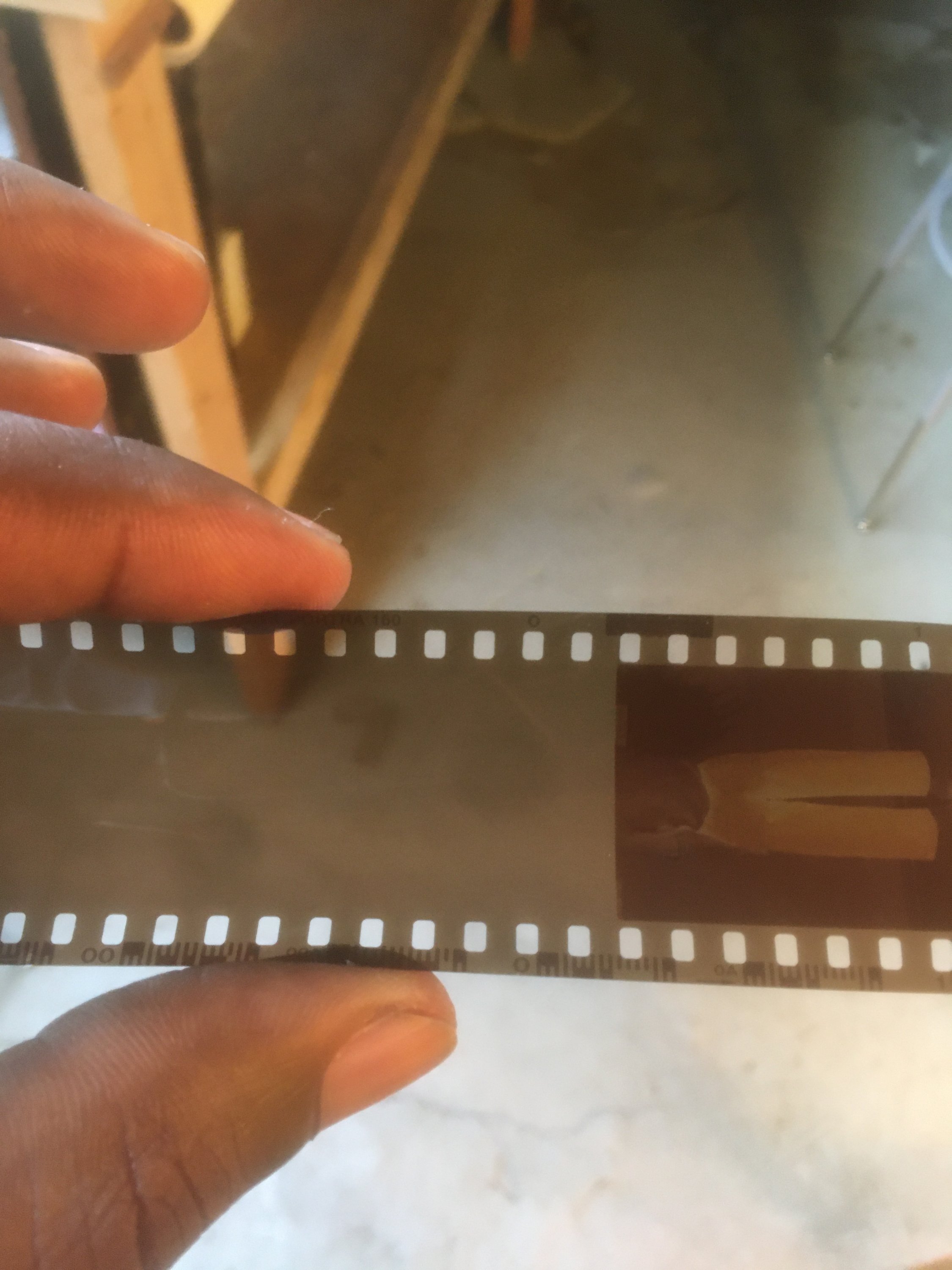

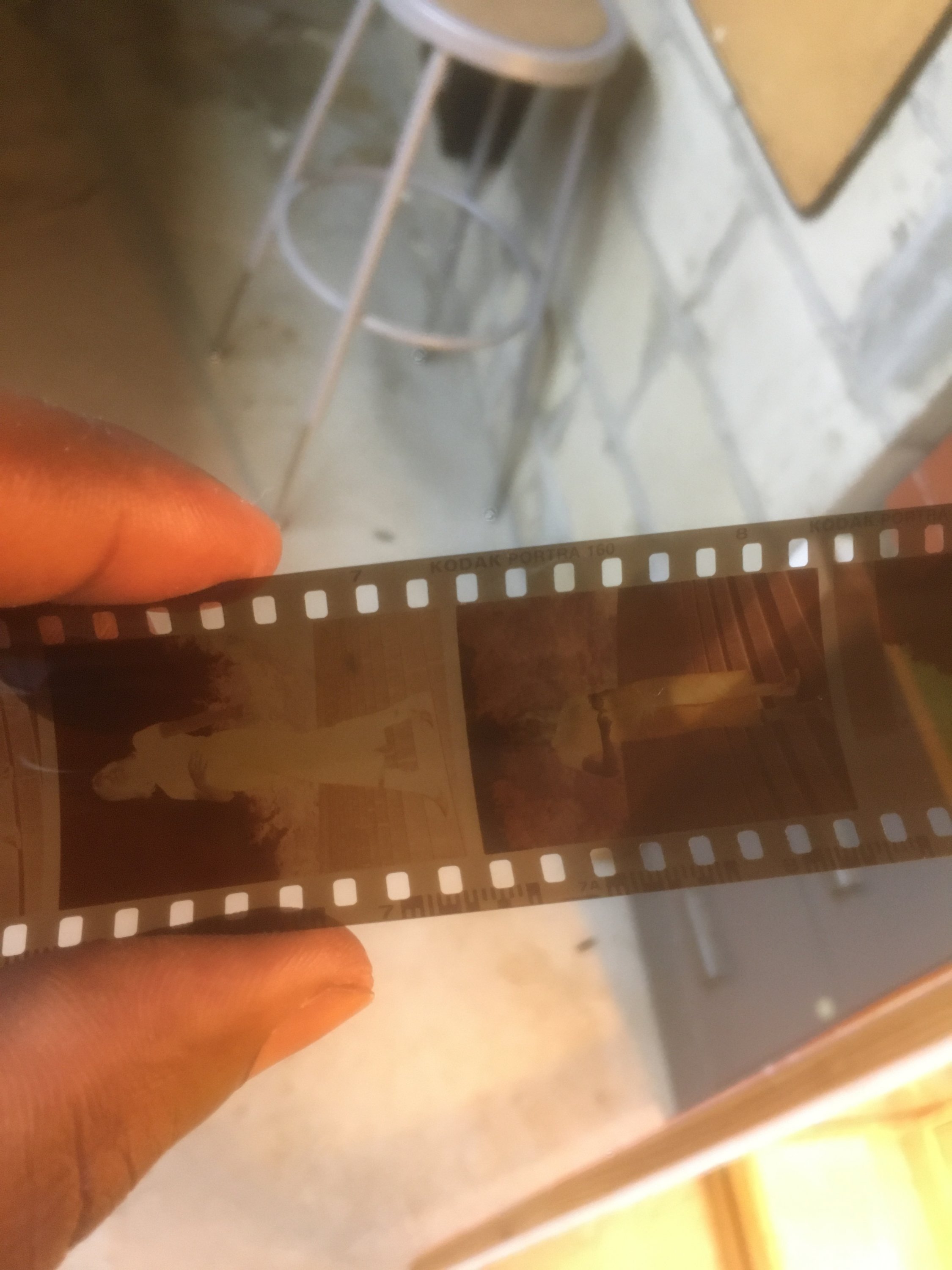

Hey everyone! thank you so much for the help. HEre are some photos:
Additiaonly I'm gonna re bleac hand fix again becasue I do remebr being kinda scared when I took it out after washing and by then the bleach had probably colled and I didn't give the machine time to re heat it (casue I ehard you can be less on point with the tempertaure f bleach and fixer)

That looks like a pretty massive amount of fog. It doesn't look like unbleached or unfixed silver to me, but rather like overall fog. This can be age and/or temperature related, but it can also be caused by light fogging (although this is generally much more uneven, so much less likely) or a chemical mishap. In case of the latter, it's difficult to track down, but it would likely be related to something up to and including the stop bath (i.e. pre-bath if used, developer and stop bath), so bleach and fix would not be likely candidates.
I will not hurt to re-bleach and re-fix, but I doubt it will help. Give it a try.
PS; the frame with the full-body photo (looking up against the person) looks very seriously underexposed.

Okay, thank you for this. I saw some documents online and I'm assuming the film was kept poorly for now. But if anyone else has insight please let me know!
Also I re bleached and re fixed twice
