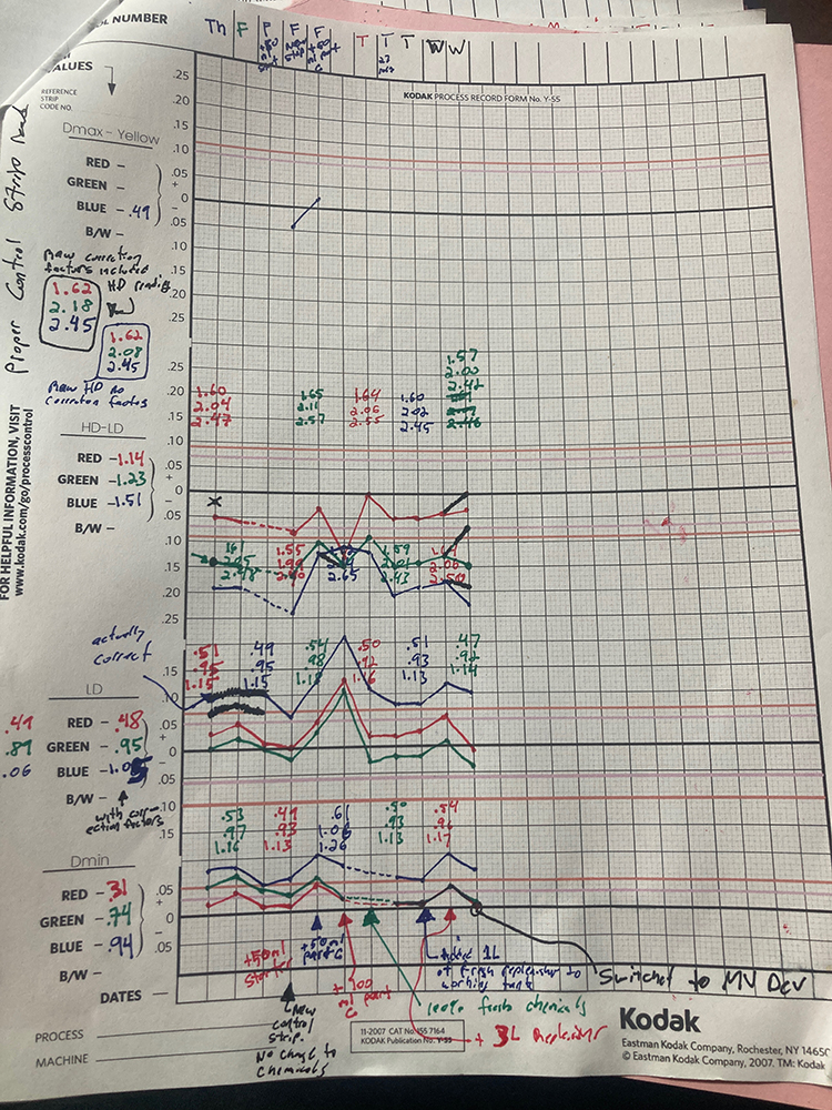

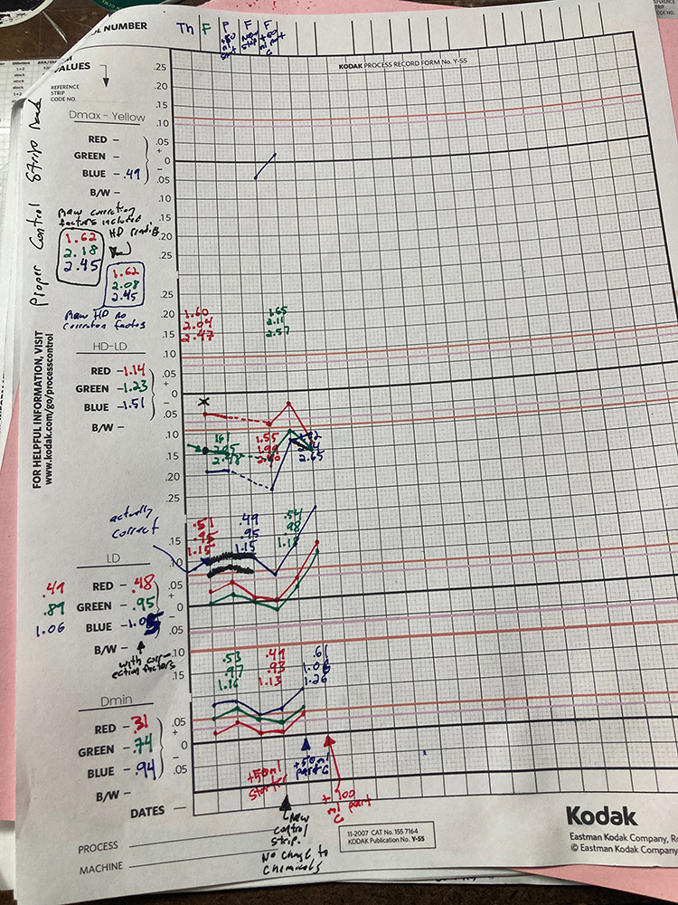

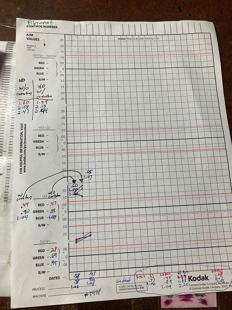

I've also added my most rescent attemps at control strips. one with the v30 and the other with my filmomat rotational machine

hhey guys, sorry for the delay my processor was down for a while. Everyhitng is back up but I'm still having issues with my test strips unfortunatly.
I decided to change my chemicals to a whole differnt version for the developer. I'm plotting very similarly to usual so the issue may be the machine it self? which leads me to ask:

I went to another lab and saw that our densitometers read the same readings. also their chemicals were in order.
What I ended up doing is putting all fresh chemicals, and then processing a control strip. I applied the correction factors provided by fuji and used that as my reference strip (instead of the one fuji provides). now I base all my control strip results to that strip and plotting is a lot better.
also noticed that I was adjusting the wrong menu item for the replenishment rates which explains why I had seen no result changes when I tried doing this before a few months back
