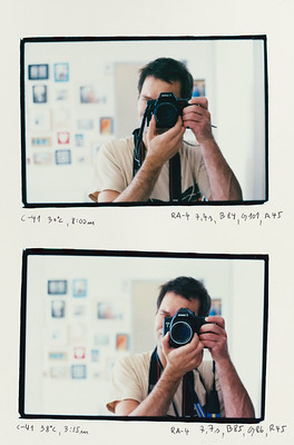

I don't think "ruining" film is necessarily the correct world. I'd really be interested in results from @mtjade2007 and @Steven Lee showing the ruined film when Jobo tank wasn't preheated properly. It's true that I never measured temperature inside Jobo tank with dry preheating, but I can definitely feel that air pressure inside the tank is higher after dry preheating which means that temperature inside the tank must be higher than ambient temperature.

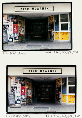

I've done tests developing at temperatures that significantly deviate from 38ºC. Even with development at 30ºC and analogue RA-4 printing I wouldn't exactly write off such a print.

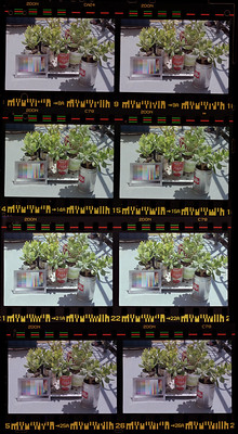

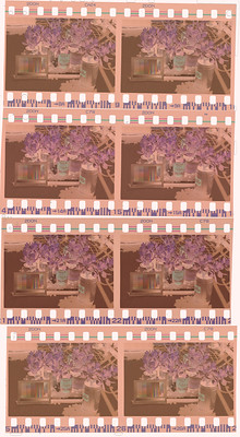

In the following test the goal was to get the feel of the maximum difference one would get if one failed to preheat the tank to 38ºC (which would mean that film would be slightly underdeveloped) and failed to stop the development immediately after pouring out the developer (which one would otherwise do with an acidic stop or bleach).
Row #2: no preheat, 3:15s@ 38ºC
Row #3: 5min preheat with 38ºC water, 3:15s@38ºC, 1min water stop
Sure, there is a difference (and that's as large as you are gonna get), but film being ruined?!
