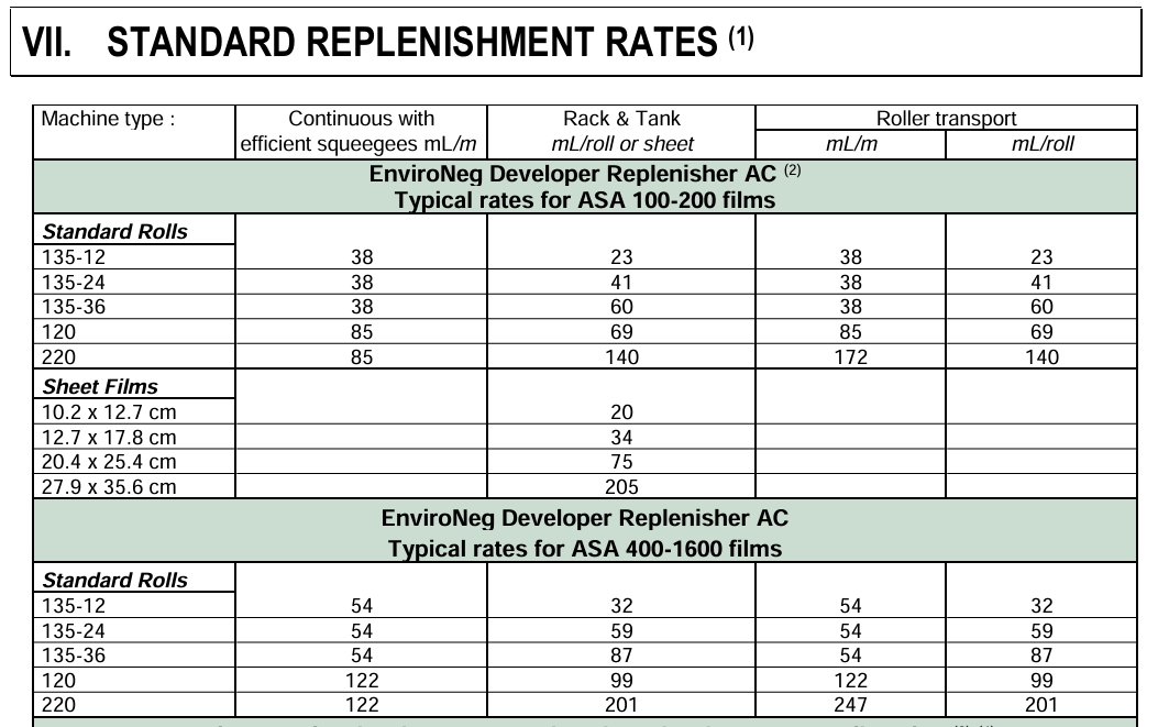

I have the Fujifilm doc TB816514 which relates to their c41 developer. it shows the replenishment rate of 40ml per 35mm roll and 52-68ml per 120 roll. I use 25ml per 4x5 sheet, a guess, and the results are good. I have used these amounts with my 1 liter paterson tank for years and get great results
Hi, given that the OP seems about to begin processing C-41 for the first time would you mind telling what you mean by "great results?" Do you verify in-spec results via control strips? Or verify that bleaching is complete? Or do you mainly mean that you have never noticed a problem, etc.?

their c41
Please note that Fuji have several C41 developers in active production and several more that have been produced in the past. They differ w.r.t. replenishment rates, in particular. One cannot (should not) assume the same replenishment rate across different products. Replenishment rates for Fuji C41 developer range from 21ml/(135-24) to 60ml/(135-24). That's a factor 3 difference between the extremes.

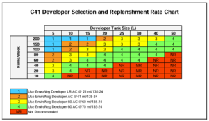

As far as I understand, the minimum tank size that is given is 5 liters. Also, the amount of replenisher depends on both the area and the film material itself.
It seems that replenishment the developer at home is not appropriate.
