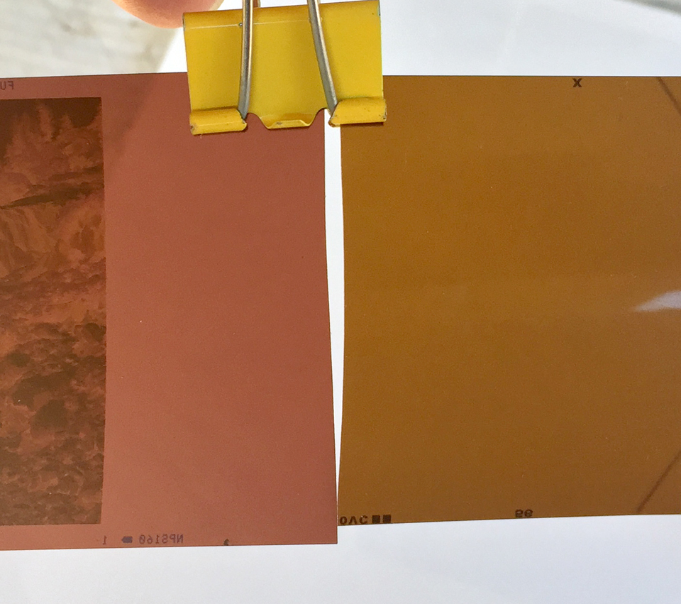

Here is a shot of a strip of normal and another strip of a bad blank neg that shows the color difference. The left is a normal one and right is the bad one.
Left is FUJI NPS160. Right is ... Portra 160 VC? Not NPS160 in any case. The former is heavily expired; the latter likely too if it's one of the Portra VC's
I'm not surprised they're different.

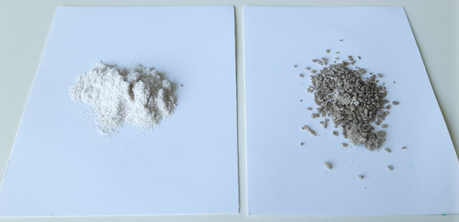

Can you post photos of both chemicals?
CD-4 should be a virtually white powder (as shown left in photo below). In the past, I have bought material that was clearly very impure and came as a tan/grey granulate (right):
(However, truth be told, they appear to work virtually identically and I never observed a difference in activity).

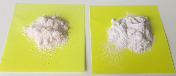

Indeed. There's a complication though. CD3 and CD4 are not all that dissimilar, depending on purity.
Left: CD3. Right: CD4.

Note that CD3 is much less active than CD4. It's possible/plausible you are now using CD3 and that's why you're running into these weird issues. Sounds like someone may have mislabeled a bag.
