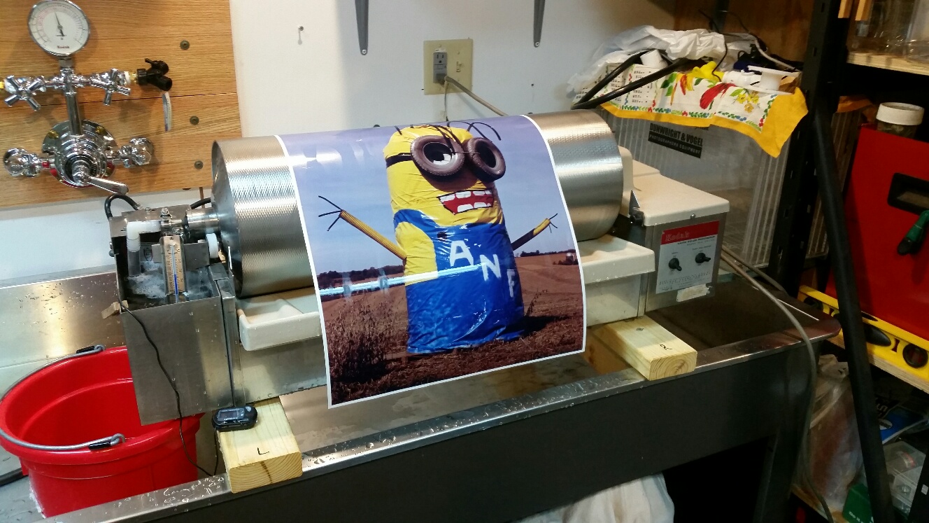

I'm with Matt ,when I used tubes I used Cibachrome and the Doran/Devtec/Premier drums. I use a Kodak rapid color processor model 11 and 16k now. The smaller one can be had for peanuts. You work in the dark. Very fast. I have 3 Thomas safelights with color filters you can see well after about 5 minutes in the dark.
If you use tubes use stop bath to prevent stains
I also have some narrow SS tanks that hold close to a gallon. If you have 8x10 film hangers ,you can process two sheets, back to back in one hanger and easily accomodate 3 or 4 hangers per run.
As long as you pre-rinse and don't get damp fingers on the emulsion damp shouldn't be too much trouble.
