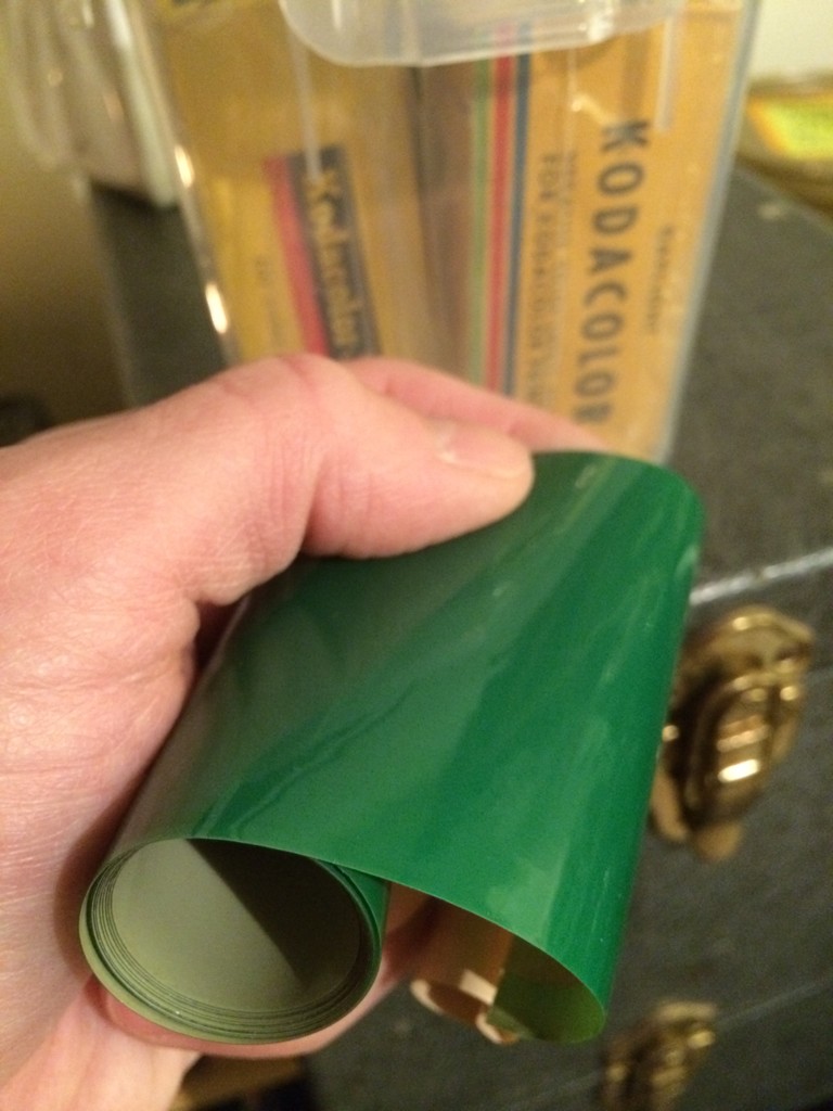

That's a shame, I just "wasted" two "fresh" rolls (one of each of those) and re-rolled with 70mm HP5+... I needed the backing paper and spools... I feel bad now... It's a neat color though...
I tried selling them first here in the classifies but no one wanted them so then I listed on eBay and no one wanted them there so I gave up and unrolled them to use the backing paper... Sorry guys... :sad:

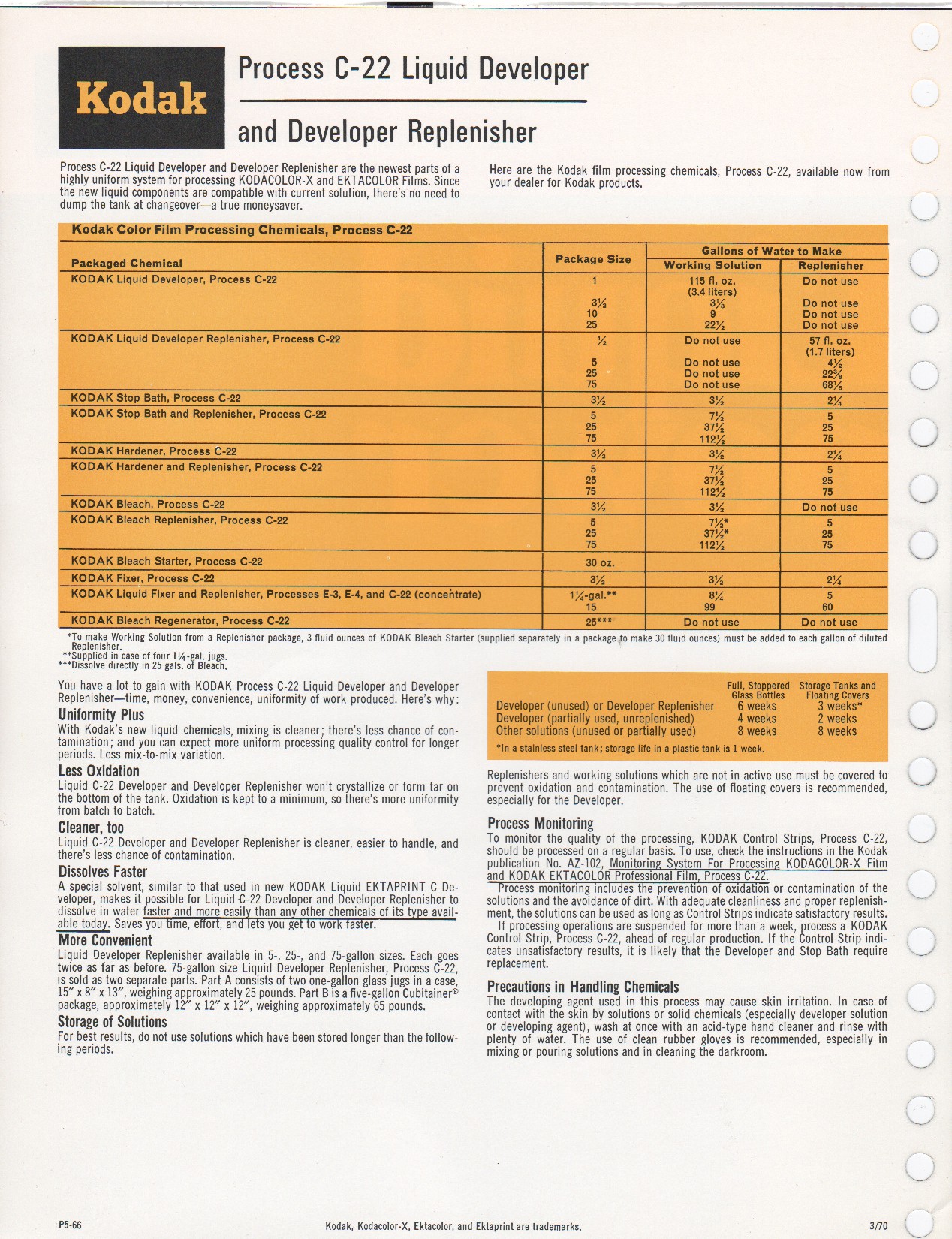

Just for the record on Process C-22 Liquid Developer, here's a Kodak marketing sheet on it from 1970 that I just got.
I've got several 1 gallon developer kits, so I may mix one and see how it works on some High Speed Ektachrome. (I have mixed hardener, bleach, and fixer left over from a powder 1-pint C-22 kit.) Curious to see if the sulfur dioxide made Part A long term stable. Won't know until I open that bottle and see if it stinks.
