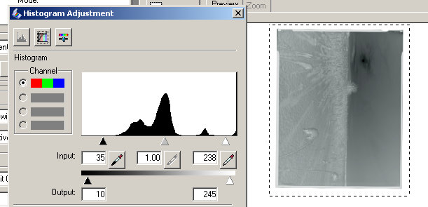

I did some densitometery using my Epson (with a Stouffer wedge) and seldom get anything as dense as 17
A fully over exposed sheet (developed normally, not in my new dektol method ;-) gives me a density curve like this, looking at the histogram of Epson scan:
I find that exposing for shadows and letting the hilights fall were they may I normally get a density range on my negs like this:

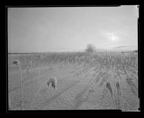

For instance ... looking right into the sun:
I was able to get a nice smooth set of tones in my scan:

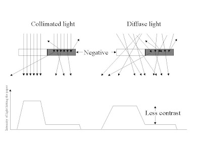

just in case, this diagram should help those who are unfamiliar with the effect Bruce mentions
