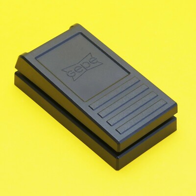

Both Gepe and Pakor made two styles of glassless plastic mounts, ones that simply press together or pry apart to mount, and ones that require a machine. The mounts designed for machines cannot be used by hand, as the machine either melts or deforms rivets to lock the halves in place. At this point, given that the mounts are no longer available new, it's not worth tracking down a machine to use the mounts unless you come across a case of a few thousand mounts.

The plastic Pakon mounts with the foldover rivet style are very easy to use with a small flat-tipped soldering iron. I've mounted hundreds of slides with these. If you find/see a box of 1000 of these for cheap, don't be afraid to get them. I few trials and you're on your way.

For 6x6 and 6x7 slides, I recommend glass slides. A few years ago I scoured eBay for some time and accumulated enough glass 66 &67 to last my lifetime. It just takes some time and perseverance but worth it. For 35mm glassless will do. The plastic Gepe are easiest to work with.

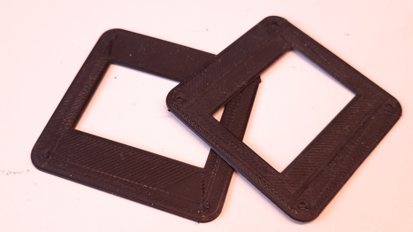

With supplies really seeming to dwindle now, I wonder if it would be viable to investigate 3-D printing mounts as a community? I’m aware of the standard arguments that slide shooters’ “niche within a niche within a niche” status means there’s not really a commercial argument to catering for us specifically (fair enough!), but for those of us that just can’t do without projection there must be a way to find some sort of collective independence.

Regarding your second point, the mounts themselves don't seem complicated and only consist of two materials - cardboard and dry mounting tissue. I don't think you'd use 3D printing, but a diecut machine like the Cricut to cut out the mounts. I'm still exploring making my own mounts, but I have to find the correct materials to use in regard to thickness. Even if I find the right materials, I think it might be cost prohibitive to make my own mounts.
I tried it once, for the heck of it.
It's a non-starter for production purposes. Throughput is way too low even for a niche-within-a-niche market and the tolerances are dodgy for this purpose.
Slides mounts are fairly easy shapes, to the reasonable way to do this would be to get a die made in China and die cast them, or die cut if it needs to be cardboard/paper.

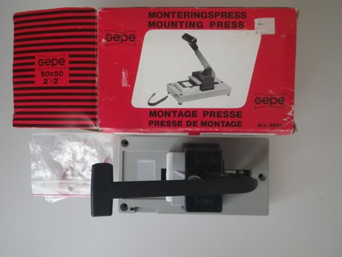

Many decades ago I used those mounts, as well as the glass mounts too, and they definitly can be snapped together between fingers. Gepe made a mounting press that made the chore just a bit easier and reduced the risk of tweaking the glass mounts, which could break the glass. Here is an example:
I seem to recall some other brands making similar devices...
