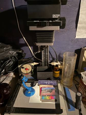

I'm looking around at various shopping forums (FB Marketplace, OfferUp, Craigslist) looking for my first enlarger. There's a range of options ranging from ancient tiny enlargers to large models from Beseler, Omega, Durst, etc.
I'm trying to decide if I should start simple (just enough to do 35mm and 120) or try to get a big one that can do 4x5 so that I'm covered when I go up to large format.
Many of the ones out there have color heads, which would be nice for RA-4 and VC
Are there any brands or models I should avoid, or prioritize? Any tests that are a good idea to run (beyond just turning it on and seeing if any fans work)?
Any other shopping tips? Right now I will be using a Nova darkroom tent so I probably need to make sure that whatever I buy fits in there :smile:

I should not be surprised by how quickly people have jumped in with great advice but I am definitely still grateful :smile:. Let me list some of the options I’m coming across and ask advice. There are a lot of darkroom postings in the PNW right now on Craigslist and OfferUp and FB Marketplace, including the tempting in Blaine that Mike posted.
