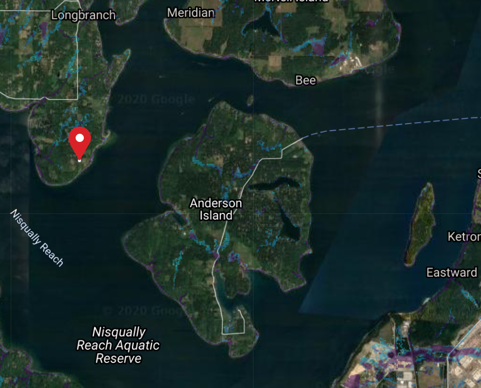

We're looking at this spot on Saturday. The land is already cleared, flat, and ready for the house!
Just north of Olympia I see.
Will it flood with the onset of global warming?
Interesting. I have neighbors who just bought a big house on one of the islands and are in the process of moving. There are probably strict rules in place regarding effluent.
We drove to that first property today. It won't do. Too small lot, well water, and there is a sign on the gate in front of the subdivision that says all homeowners must boil their water before drinking it for now. So this place is a no-go for multiple reasons. No problem, lots more lots to look at.

Absolutely right. Drew, you would have had a field day with the property we just saw. It is on a hillside above an inlet to the sound. Clay soil and what a mess!! I will defintely heed your advice for the property that checks all of the right boxes in my wish list.
Also on the west coast, Tsunamis.
The Cascadia fault will send a tsunami into the Puget Sound. Whether the wave will make it with any significant energy all the way to the south end of the sound is another question... but, great observation.
The property is about 75' above high tide so, no. It probably won't. On the other hand, I'll be that much close to having beach front property
And that property means that the beach then will be/ may be restricted to you? (I ask as I do not know the legal situation in your part of the world.)
